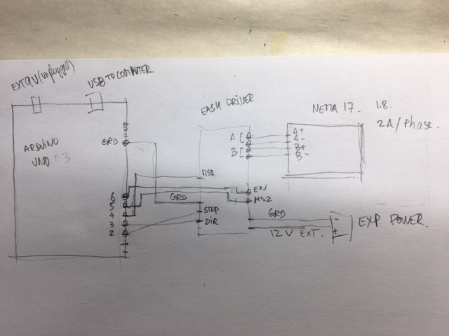

Hi Everyone,
I'm a beginner, first post.I read the "how to use this forum" a couple times, and i'll try to stick to the rules.
Please let me know if there is something i'm not doing right, (i think you will!) and i'll make the corrections.
I also spent days looking for a solution on this forum and elsewhere (the AccelStepper Google group for example)
setup
Arduino uno + easy drivers + Nema17 (specs/datasheets below)
Problem
The unexpected behavior with the Arduino example "stepper_oneRevolution":
>>> The motor doesn't go backward.
After setting the step per revolution to 1600, it goes counter-clock wise half a revolution, then again counter-clock wise 1 full revolution.
To start with and match the wiring (Easy Driver Hook-up Guide - SparkFun Learn), I changed the pins number from this:
Stepper myStepper(stepsPerRevolution, 8, 9, 10, 11);
to this:
Stepper myStepper(stepsPerRevolution, 2, 3, 4, 5);
I also tried to swap 2 and 3 and a few other combinations with no success. I got it going backward at some point (2,4,3,5 if i remember) but the Forward and backward moves weren't symmetric.
I looked at the Stepper.h file but couldn't find anything obvious. (not much coding knowledge here)
Questions:
Since the demo Sparkfun code seems to work (as well as other codes from this forum, as long as they don't use the Stepper.h or AccelStepper.h:
  1. Is it a wiring issue that wouldn't show up with simpler codes (pins not used ...)?
  2. Do i need to tweak the stepper.h library?
  3. Is it something else i'm not seeing/aware of?
Thanks in advance, any help will be greatly appreciated.

Your motor requires a driver that can provide 2 amps per coil. An Easydriver can provide a max of 0.75 amps. Unfortunately the BigEasydriver is unlikely to provide 2 amps either and you may need a more expensive driver that can supply 3 or 4 amps so as not to be right at its limit. I guess you could use a BigEasydriver or a Pololu DRV8825 with the current set low (say 1.5 amps) but then you won't get the full value from your motor.
When you have sorted that out this Simple Stepper Code should be good for testing,
The standard Stepper library is not intended for drivers that take step and direction inputs. Use the AccelStepper library with the DRIVER option.
Fritzing diagrams are so easy to misunderstand as to be almost useless for anything other than art. A photo of a simple pencil drawing is almost always more useful.

Thank you for your (lightning fast!) answers Robin2.
I will do more research to find a good match (motor/driver) that meet my needs (camera slider for Mid weight camera rigs)
Although there is something i don't understand.
1)Why does it seem to work as expected with the EasyDriver Demo code if the driver is not capable of driving that specific motor?
  1. Could it be that the amazon link is pointing to the wrong motor specs?
  2. Can i measure how much the coils are expecting myself and would you happen to have a link (handy) that would explain how to please?
Hi again Robin,
I have a couple A4988 and looking at the specs it says: "It is designed to operate bipolar stepper motors in full-, half-, quarter-, eighth-, and sixteenth-step modes, with an output drive capacity of up to 35 V and ±2 A
Do you think that be enough to start with? At least to have the AccelStepper code to work properly?
ps: i'll make a drawing of my EasyDriver setup now.
Thanks,
Stefan
Here is the drawing of the EasyDriver Wiring.
Hi again Robin,
Thanks a bunch!
I made a second setup (kept the other one as is for now) with an A4988 (from reprap).
I started by following the wiring found in this post (message #10)
Then reading through the discussion, i followed your suggestion to wire MS1, MS2 and MS3 to the ground.
Next i changed the pin values in your simple stepper code and uploaded it.
First it did something a bit strange at the very beginning, turning one way and reverse a few dozen steps, before going 200 steps full revolution one way, then the other way.
After tweaking the driver pot a bit i got it to not do the weird thing before executing the program.
Bingo!
Now, may i ask you about the AccelStepper way of controlling the motor?
Would you have/share a link to some simple stepper motor control (like yours, going 1 rev back and forth) but using the AccelStepper library? One that you have tested with success with the same setup of yours?
Or is the "Bounce" example form AccelStepper is supposed to do that already?
I tried it and it just keeps going forward by 1,25 rev chunks (accelerates and decelerates, brief stop, go again ... )
I will look more into the DRIVER mode you mentioned ( i briefly did already), although it might be beyond my skills as of now.
Thanks again for your time, it helped me solve a problem and learn a bit more already!
Stefan
Hurray!!!
I found how to set the DRIVER mode in this link
Quote from MikeM
you need to set up AccelStepper in the 'stepper
driver' mode. This means it will control 2 output pins, one for direction and
one for step. You will need to construct your AccelStepper something like this:
AccelStepper stepper(1, 10, 11);
the 1 means 'stepper driver' mode
10 is the pin to be used to step
11 is the pin to be used to direction
I set mine to (1,3,2) and very much enjoyed looking at the result right away!!!
I guess i'm on my way.
I'd call this a solved problem. I'll safely wait a couple days before i add "Solved" to the title.
Let me know if i need to share more details for others to benefit (we never know) from this.
THANKS!!!
Stefan
