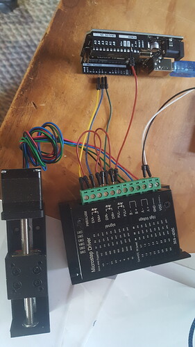

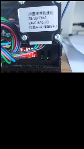

OK, this should help a lot. A pic of the setup, and a pic of the side of the driver.
1st, do I need to run a ground from the Arduino to the driver ? If so, where would I attach that on the driver ?
Here is the basic code I have for now, will it work ? It DOES work on a tiny stepper/driver I have that was in the Arduino kit.
When I try to load it on this new bigger setup, it says can't find the device. Anyhow, here is the code, followed by the error message it gave me.

ketchavrdude: ser_open(): can't open device "\.\COM4": The system cannot find the file specified.
That indicates a communication problem between the Arduino and the PC. Did you choose the right serial port in the Tools, Ports menu?
Stepper myStepper (stepsPerRevolution, 8,10,9,11);
Your driver is a "step/dir" driver so the Stepper library will not work. Use the AccelStepper library when you need acceleration.
Your driver is set for 3.5 Amps to the motor coils. You must set the coil current to your motor's coil current specification.
Your driver is set to max multistepping. I would set it to 4 or 8 testing.
