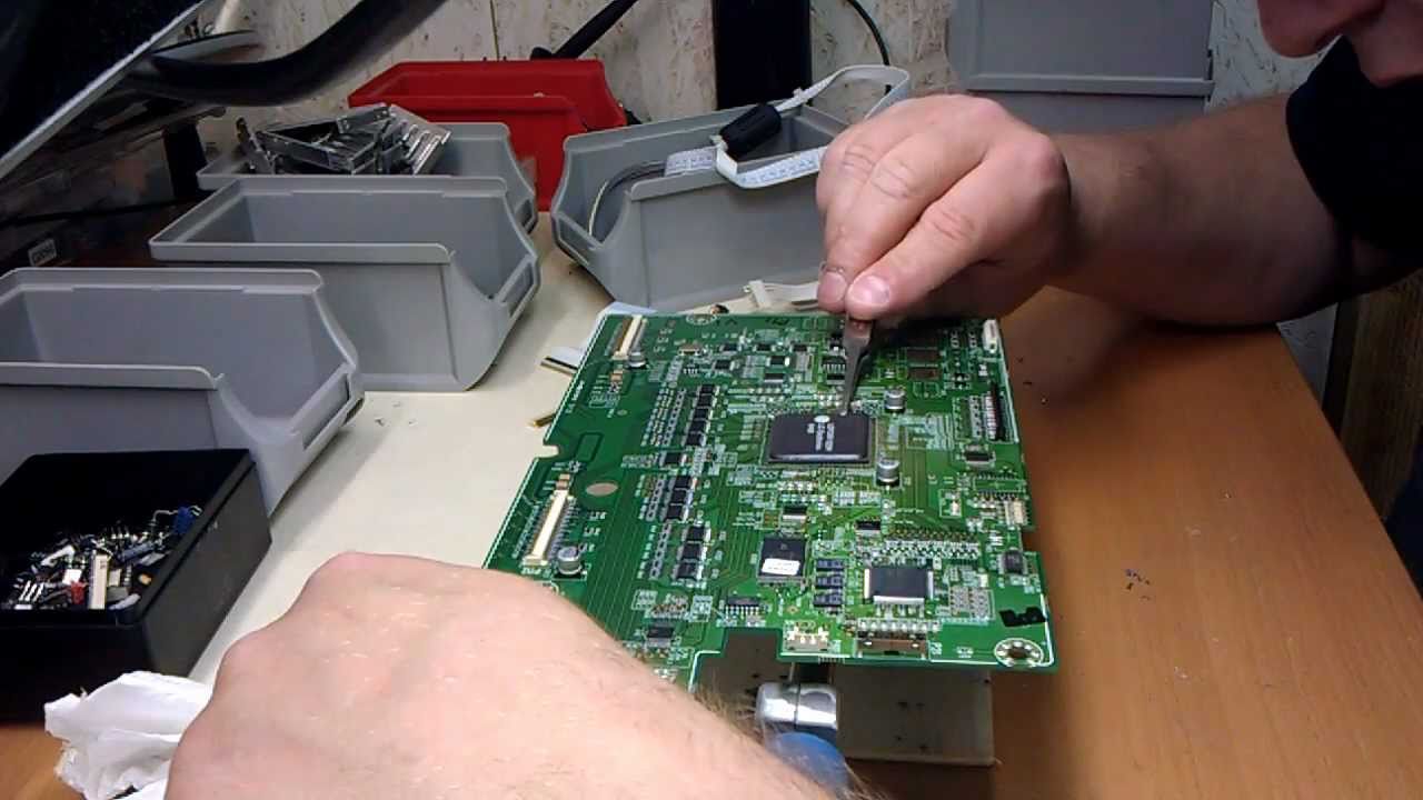

I have drums in my back yard filled with scrapped circuit boards from everything. I would like to remove all the components. I do not have a need for the components or circuit boards for any electronic purpose.
I want the flat printed circuit boards. I will panel a room in my house entirely with the flat circuit boards.
I was thinking, I can use the toaster oven and the gas stove top with some gloves to heat up. The overhead exhaust fan perfectly removes the fumes. A pair of tweezers, needle nose and just shake and pick them off.
Does anyone else have a better idea, advice, experience ? This is the best I can come up with.
Clamp by the edges in a vice and hit with a hand grinder. Maybe enlist help to replace the board in the vice with another one, or you do it and the other person handle the grinder.
There are also simple un-powered "pencil" style ones that I have used, but they are of dubious effect. My soldering station has a powered vacuum placement tool that works quite well, but the whole thing was around $100 at Circuit Specialists.
The angle grinder would probably scathe the surface of the circuit board.
I do have a solder pot. Mine is about as small as that one. I never thought to fill it and use the meniscus to wave unsolder the bottom surface. Great idea, thank you very much.
I am surprised someone has not mentioned - again - this:
Heat with hot air or flame, have a sturdy wooden block ready on the concrete floor, when hot, holding with heavy pliers, hit the board by the edge on the wooden block.

I would just use my hot air gun to heat the components one at a time and flick them off the board with a screwdriver blade. That might get tedious for a full roomfull of boards.
If you really want to make a production line for it, I would set up a linear flame burner with a steel bar just in front of it. Then drag the boards over the bar to scrape off the components just as they are heated. That does assume 100% SMD, so maybe you have to deal with through-hole components as a separate step first.
My favourite desolder tool is a Hakko 808. I can usually re-use both the components and the board with this tool. Without the Hakko, I have to choose between saving the board or saving the component.
