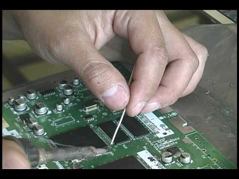

ChipQuik was designed for desoldering surface mount chips:
