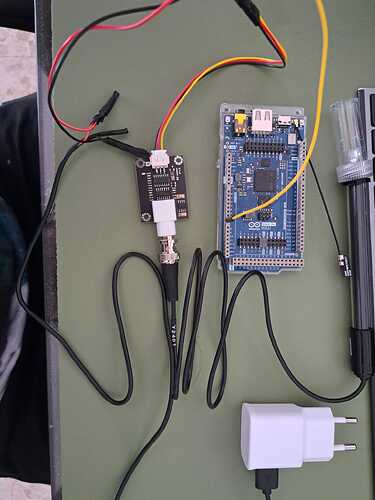

You should tell what arduino board you have and how it's wired to sensor
I have Arduino GIGA R1 WIFI, and for this test I have disconnected all sensor and I left only pin A7 for the sensor, which is powered by a 5V plug, as per the product instructions
more precisely?
Please just tell your wiring.
Are you aware that you have 3.3V board and 5V sensor?
this is the circuit. I hope I answered the question
I don't see your arduino being powered at all...
Just describe, are they powered from separate power supplies?
Like arduino from usb and sensor from 5v adapter?
exactly arduino from usb-C and sensor from 5V adapter
@kiry32
The minus (-) of the EC board need to be connected to the Arduino GND
Ok

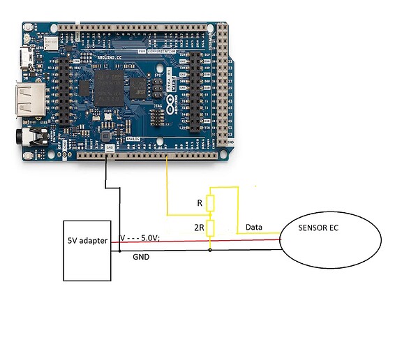

You have two major issues here.
First, sensor GND and arduino GND have to be connected.
Second, I'm quite sure that your sensor is outputting 0-5V and your arduinos analog input can handle only 3.3V.
I see from your mistakes, that you are completely beginner in electronics, that's why I make a question: do you have an other arduino board, Uno, Nano or whatever 5V board?
Would be easier for you to get started.
no I don't have any other cards, and yes I'm not very knowledgeable in electronics, how can I solve this by using this card?
I have try to connect GND on board, but the sensor remains off, it does not turn on
First, you need to make connection between sensor GND(-) and arduino GND. Alternatively you might be able to power your sensor from arduino 5V and GND pins but I can't guarantee without datasheet of your sensor(max current draw).
Second, you need voltage divider to read that signal from sensor. That can be built with resistors, do you have?
You still need gnd from power supply, connection to arduino is "extra wire"
Also stop playing with wires randomly, you risk to damage your expensive arduino! Disconnect that sensor output wire from arduino.

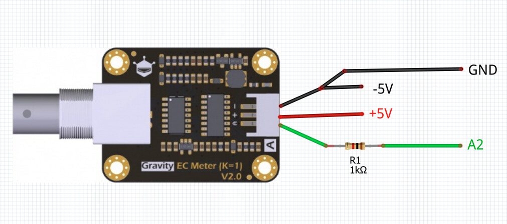

this is dataSheet :
Technical Parameter
  • K=1
  • Operating Voltage: +5.00V
  • PCB size: 45mm *32mm
  • Measurement range: 1ms/cm--20ms/cm
  • Applicable temperature: 5-40 C
  • Accuracy: <+10%F.S. (Specific accuracy depends on your calibration accuracy)
  • XH2.54 Interface (3-foot patch)
  • BNC interface conductivity electrode (electrode constant is 1)
  • Conductive electrode cable length: about 60 cm
  • Power Indicator Lamp
Wiring diagram
EC Meter--Arduino
  • V - - - 5.0V;
  • G - -- GND;
  • A - Analog IO (corresponding to source code)

I Use this schematic, for this values:
average total is convert for 3.3V:
    //averageVoltage = AnalogAverage * (float)5000 / 1024;
    averageVoltage = AnalogAverage * (float)3300 / 1024; // Using 3.3V reference
What is your solution ? I not understand sorry
Connect like this
ok thx, I try

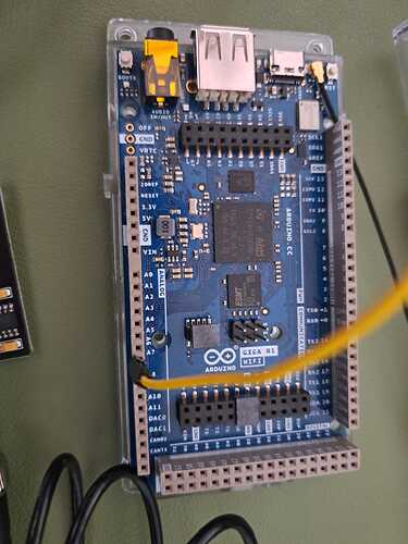

Also use any analog input other than A7
A7 is also connected to the Audio jack
You also need a potential divider to reduce the sensor output from 0-5V to 0-3.3V.
You need the potential divider in place before you make the change in the code that you posted in post #15.
You never answered kmin's question.
Do you have any resistors to make a potential divider?

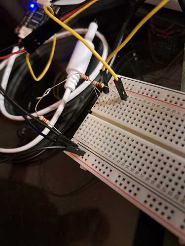

This is the R
I see 3 resistors instead of 2. Can you describe your divider setup and resistance values used?
