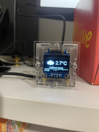

Recently I purchased DIY weather station on Amazon and after putting it together I found out that it shows time in China timezone, sale goes for weather (I'm based in London). Since couple of days I've been trying to figure out how to read the code from SPI flash so that I can edit the location to fix the time and weather information.
Can someone please help me with some resources/instructions on how to use Arduino IDE and Arduino UNO to read and modify existing program on the ESP01S, time is displayed on small OLED, its very basic setup, I just need to figure out how to modify existing code.

I've done all of the above, I've contacted the supplier and requested a refund, although I would really love to get to the bottom of this, I feel like it will be a one-liner change in code to get the correct location and weather. I've connected the ESP01s to both RX and TX pins but when trying to use AT commands with Arduino IDE I don't get any response.

The weather is pulled in by weather api, unfortunately this api does not support different countries, only China cities, I also have difficulties with reading in Chinese so need to Google translate everything which may be error prone. Initially I’ve tried to manipulate the data passed into the ESP01S but couldn’t find a way.

Well yes you are qualified then. The main thing is to find which oled is being used and how it is connected, then writing a simple program to connect to a network and retrieve the information you want and display it. It is a bit of a job, and once you start uploading anything new onto the ESP-01, whatever was on there will be erased.

Thats the problem, and thats why I've raised this question. I didn't want to lose the program that is currently on the ESP01s that was included within the DIY kit, if I flash new program on it, it will erase the previous one, therefore I wanted to figure out how to read the program, given all the answers here, I've ordered 3 new ESP01s components, will do some coding on my own and swap out the ESPO01s from kit with the new one with updated program.

After figuring out how to code onto ESP01s and how to adapt to the PCB from Chinese kit, I've managed to install weather station program onto it and it actually worked. Once again, thank you trying to help!
