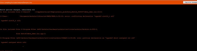

I'm trying to compile my Fm transmitter project using the Fm transmitter shield from elechouse and Arduino Uno. I'm trying to use their example code but I always get an error as shown in the images.

Arduino: 1.8.2 (Windows 10), Board: "Arduino/Genuino Uno"
In file included from C:\Users\v Domingo\Documents\Arduino\libraries\FMTX\examples\fmtx_demo\fmtx_demo.ino:16:0:
C:\Users\VDomingo\Documents\Arduino\libraries\FMTX/FMTX.h:32:18: error: conflicting declaration 'typedef uint16_t u16'
typedef uint16_t u16;
In file included from C:\Program Files (x86)\Arduino\hardware\arduino\avr\cores\arduino/Arduino.h:233:0,
from sketch\fmtx_demo.ino.cpp:1:
C:\Program Files (x86)\Arduino\hardware\arduino\avr\cores\arduino/USBAPI.h:30:24: note: previous declaration as 'typedef short unsigned int u16'
typedef unsigned short u16;
exit status 1
Error compiling for board Arduino/Genuino Uno.
This report would have more information with
"Show verbose output during compilation"
option enabled in File -> Preferences.

thanks for the replies.
I fixed it.
I just modify header file. and it works.

I had the same problem and I solve it doing the following modifications.
#ifndef __TYPE_REDEFINE
#define __TYPE_REDEFINE
//typedef uint8_t u8;
//typedef int8_t s8;
//typedef uint16_t u16;
//typedef int16_t s16;
//typedef uint32_t u32;
//typedef int32_t s32;
#endif
u8 i,buf[4];
with the line
uint8_t i,buf[4];
and the code uploads just fine.
