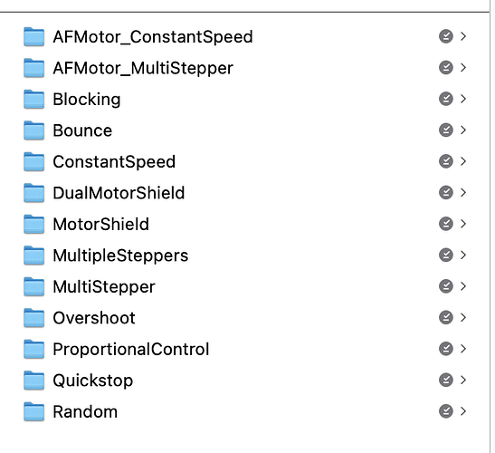

Try AccelStepper from your IDE Library Manager. It allows for a slower power/ramp.
Hi sonofcy
Thank you for your reply.
I am new at this can ytou maybe point me to an example that I can look at?
Accelstepper has already been mentioned, look at the examples there.
IDE >> FILE >> EXAMPLES >> (your device) >> (example sketch)

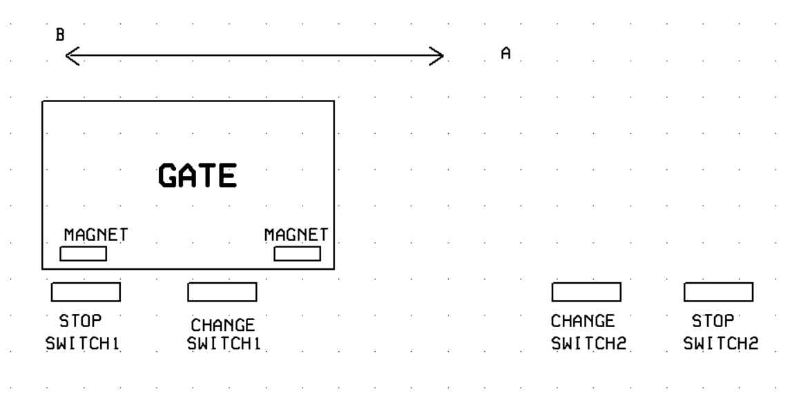

Hi, @lappieslatandra
So you need controlled LOW and HIGH speed.
So you will need to know some intermediate positions of the gates travel.
Look at this diagram, of gate with an extra set of switches.
In this case I am using magnetic/inductive sensing.
From the position shown, to OPEN, STOP SWITCH1 is active, the gate moves SLOWLY to the first CHANGE SWITCH1 and activates it, where it goes to HIGH speed.
When it activeates the CHANGE SWITCH2 the speed drops to SLOW and when it activates STOP SWITCH2 the gate stops.
A similar procedure when you open the gate.
The gate that at my workplace has an encoder on the gate and just two limit switches.
To set it up, it does a very slow open and close to LEARN where the ends of the gate travel are.
Then in normal operation using the encoder it has full control over acceleration and deceleration.

Then based on the name AccelStepper I think that is what you need. You will need to learn that library (see examples (pic enclosed)) then change all your existing stepper code to use the AccelStepper API.
Hi, the only problem I have it is not a stepper motor it is a dc motor.
