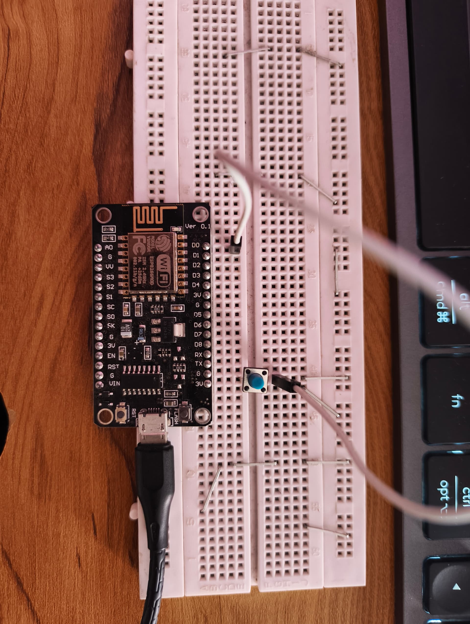

I have connected a two terminal button with an ESP8266, one terminal to the D0 and another to the 3V and uploaded the following code.

The code simply increment the count variable everytime the button is pressed. It works fine but I noticed an interference when I touch the staple pins(I use these to make my circuit look cleaner) on the breadboard.
I tried adding a resistor to solve this problem but it didn't worked well.
Please suggest some possible solutions.

I get that it should be connected to GND since the pinMode is initialised with INPUT_PULLUP, but the button perfectly increments the count when toggled. Also, when I connect the other terminal of the button to GND, it does nothing. Please explain if there is something I am not able to understand.

D0 is GPIO16 and is the only pin that does not have a pull-up. That is why it "kind of" works and why you have interference.
Use a different pin with pullup and connect button to GND.
Yes, now pressing the button makes the count increment and prints

It is working perfectly. Thank you so much!
