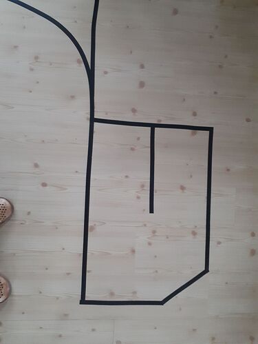

elegoo smart robot car - combining line tracking and obstacle avoidance
My son is doing a grade 5 science fair project - he was hit by a car 2 years ago, so now is very interested in learning how cars could be made to follow tracks and stops if it encounters an obstacle with sensor technology. His experiment is not to learn how to write all of the code, but just to understand how you build it and the components involved and their functions. He has built the smart robot car on his own and is wanting to have the code to do both line tracking and obstacle avoidance to test different line tracking patterns and if it stops with different size of obstacles that the smart car encounters. We are using the codes that came with the set he has bought and it has line tracking and obstacle avoidance codes separately but he wants them combined. It is a 4WD elegoo smart robot 3.0 - box set - uno controller board V5 sensor expansion board, servo and cloud platform Gp2Y0A21 distance sensor to rotate 180 degrees, ultrasonic sensor module (distance measurement and obstacle avoidance), line tracking module - black and white sensor for recognition of the white and black lanes.
We got the codes working separately so he knows he built it correctly. Here is the code we tried to combine .... its not working at all - it does not track lines and does nothing but stop when it reaches an obstacle.
with the obstacle avoidance program - it stops at obstacle and turns and keeps going until it reaches a new obstacle. With line tracking it follows the track.
I am pretty sure it will need some code to search out the line after it avoids the obstacle but have no idea how to write that.
your help and guidance to my 10 year old would be great!

We STRONGLY recommend to add comments, in order to explain program logic, and to use sensible variable names.
That way, you avoid mistakes like the following, which is nonsensical. LT_R et al. need to be pin numbers for pinMode().
#define LT_R !digitalRead(10)
  pinMode(LT_R, INPUT);
.... thank for posting it properly for me? how do i add comments is that with the the " // " I am not a programmer at all! and just wanting to get this working for my son to experiment with different tracks and different size obstacles .... sorry for doing it wrong!...
This is a line of code with a comment, using the "//" form:
Servo myservo;      // create servo object to control servo
And you're going to need a myservo.attach() somewhere. You have to tell it what pin the servo is connected to...before you try to write to it.
Perhaps you should post the two separate working programs that you tried to combine. It looks like you may have lost a few important things in the combining process.
Steve

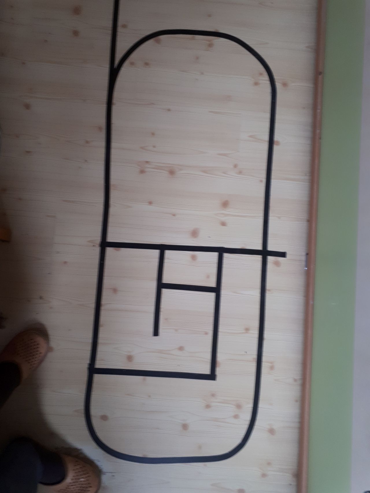

I hope I post this correctly this time:
I think now I just need the code for it to go back to the line after it avoids the obstacle!
code:

try this code use rescueLine and do rectangle line
