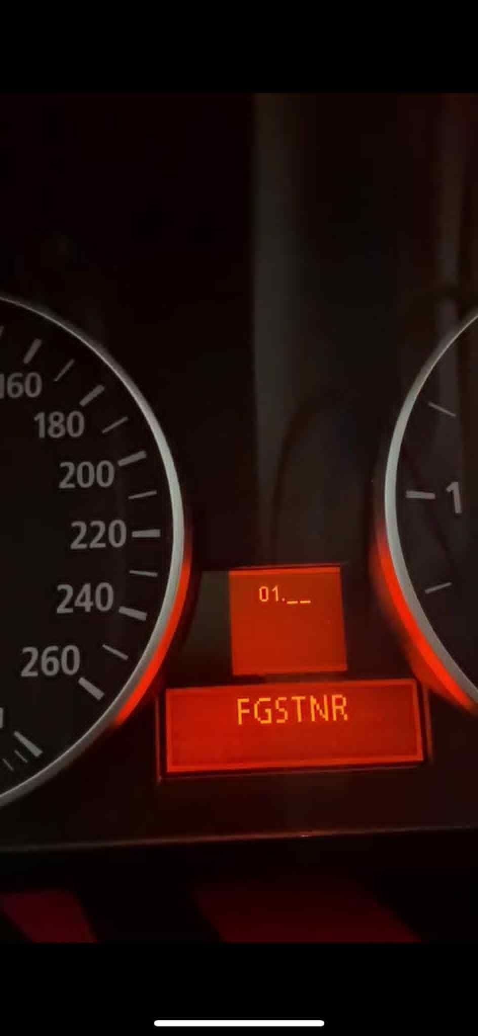

I'm trying to call up ignition simulation to enter the hidden menu in the bmw meter to enter the timer test, but the hidden menu shows for a second and disappears

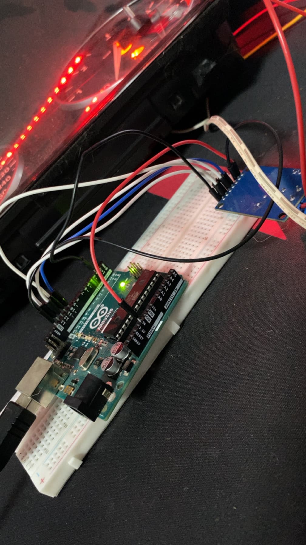

I would like to ask for help, in short I need to have access to the hidden menu so I can do a test of the clocks
USE:
arduino uno r3
MCP2515
bmw e90 meter

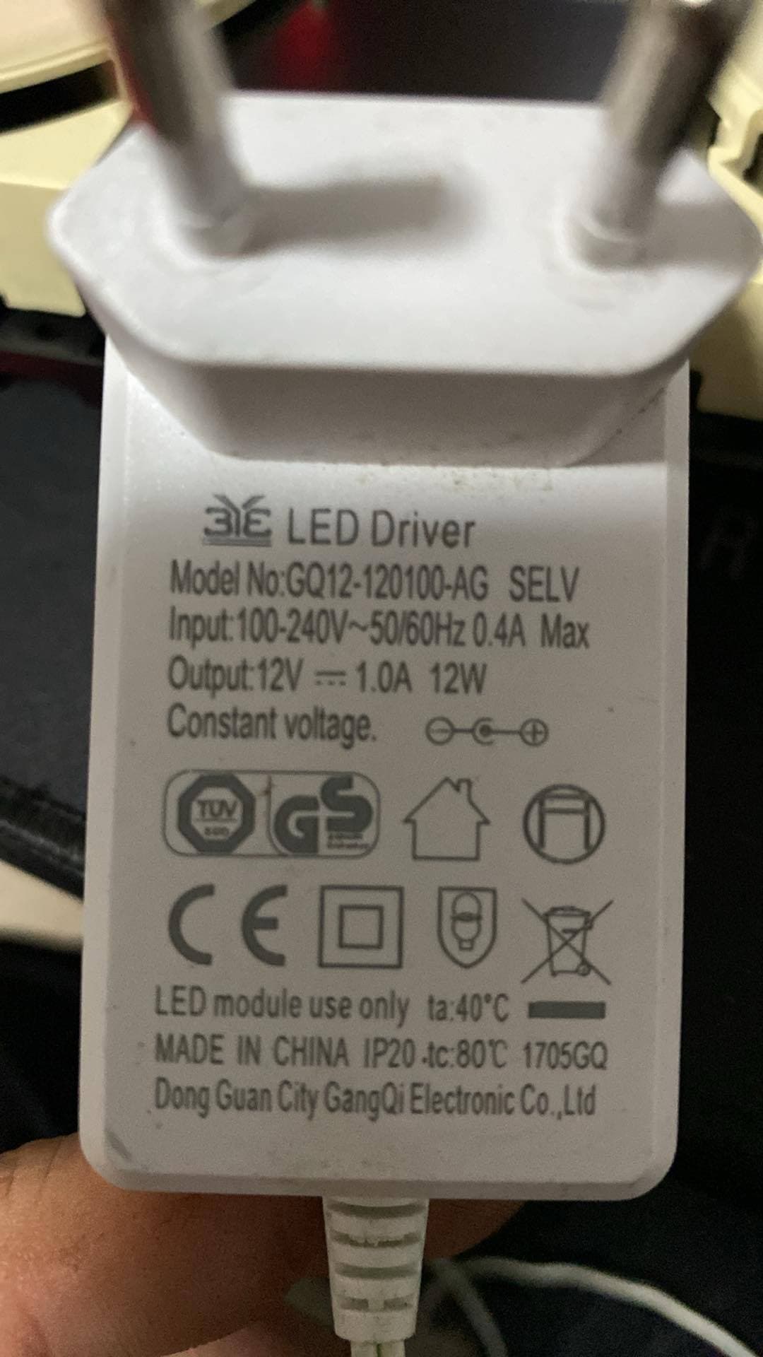

12v power supply to power the meter
Please share the documentation.
5v (arduino) - vcc(MCP)
gnd (arduino) - gnd( power supply)- gnd(MCP) -> gnd (BMW meter)
10(arduino) - CS(MCP
12(arduino) - SO(MCP)
11(arduino) - si(MCP)
13(arduino) - sck(MCP)
2(arduno) - INT(MCP)
can_h (MCP) - can_h (BMW meter)
can_l (MCP) - can_l (BMW meter)
