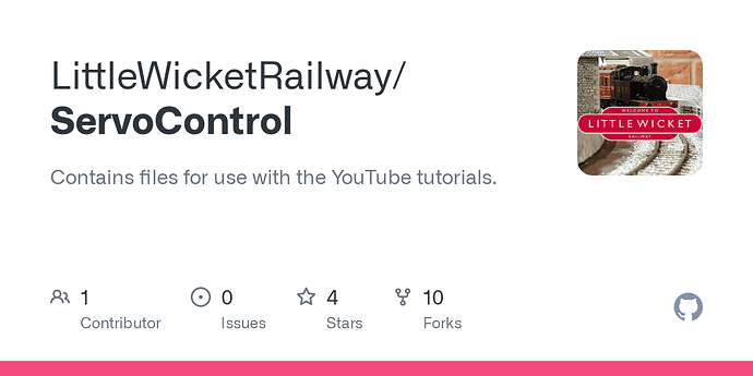

That's a video - what code did you copy?
In the Comments, there's a link to
in there is two sketches:
  1. Calibration.ino;
  2. Servos.ino.
Each one is a complete sketch in its own right - with its own pair of setup() and loop() functions.
Did you try to load the two sketches into one ... ?
