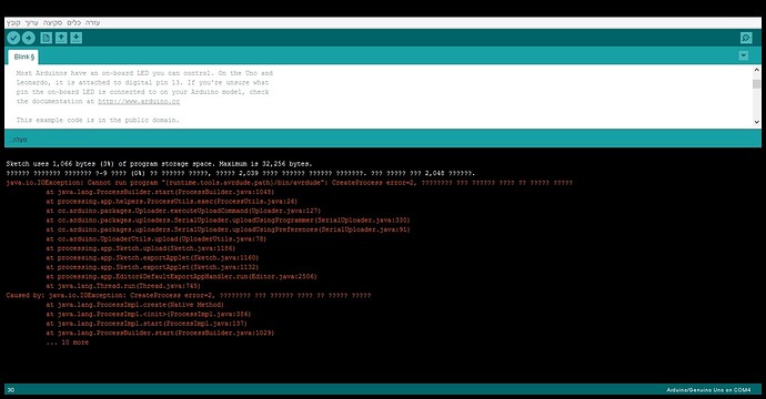

While trying to test the Blink example for the first time, I received the following error:
Sketch uses 1,066 bytes (3%) of storage space. Maximum is 32,265 byte.
(I've attached a screenshot of the full error)
I've read up anything I could find on the issue since it seemed more people had difficulties with this kind of thing, but nothing helpful.

That's not an error, it's just a helpful message telling you how much memory your sketch is using.
My PC can't read your picture (it says it;s corrupted), but the next time, you can post error messages or code use code tags.

Errors are displayed in a different color (on my system, non-errors are white and errors are orange-like). There is usually also more information in the output window. I'm using IDE 1.6.6 and if an error occurs, there is a button in the output window's title bar that allows to copy the content that you can paste here.

Edit: I just noticed, you have V1.7.9 Arduino software version. The (real) Arduino.cc versions only go up to V1.6.8.
Is that a typo, or do you have the Arduino.org version? If the latter, uninstall and instead install the Arduino.cc IDE. (I'd personally recommend V1.6.5, the last really stable version.)
Arduino Download Page
sorry for taking so long to respond, you guys both helped me at the end of the day; I uninstalled the software, and installed 1.6.5 instead, and now it shows up as a friendly error (then it didn't), so thanx a lot!
