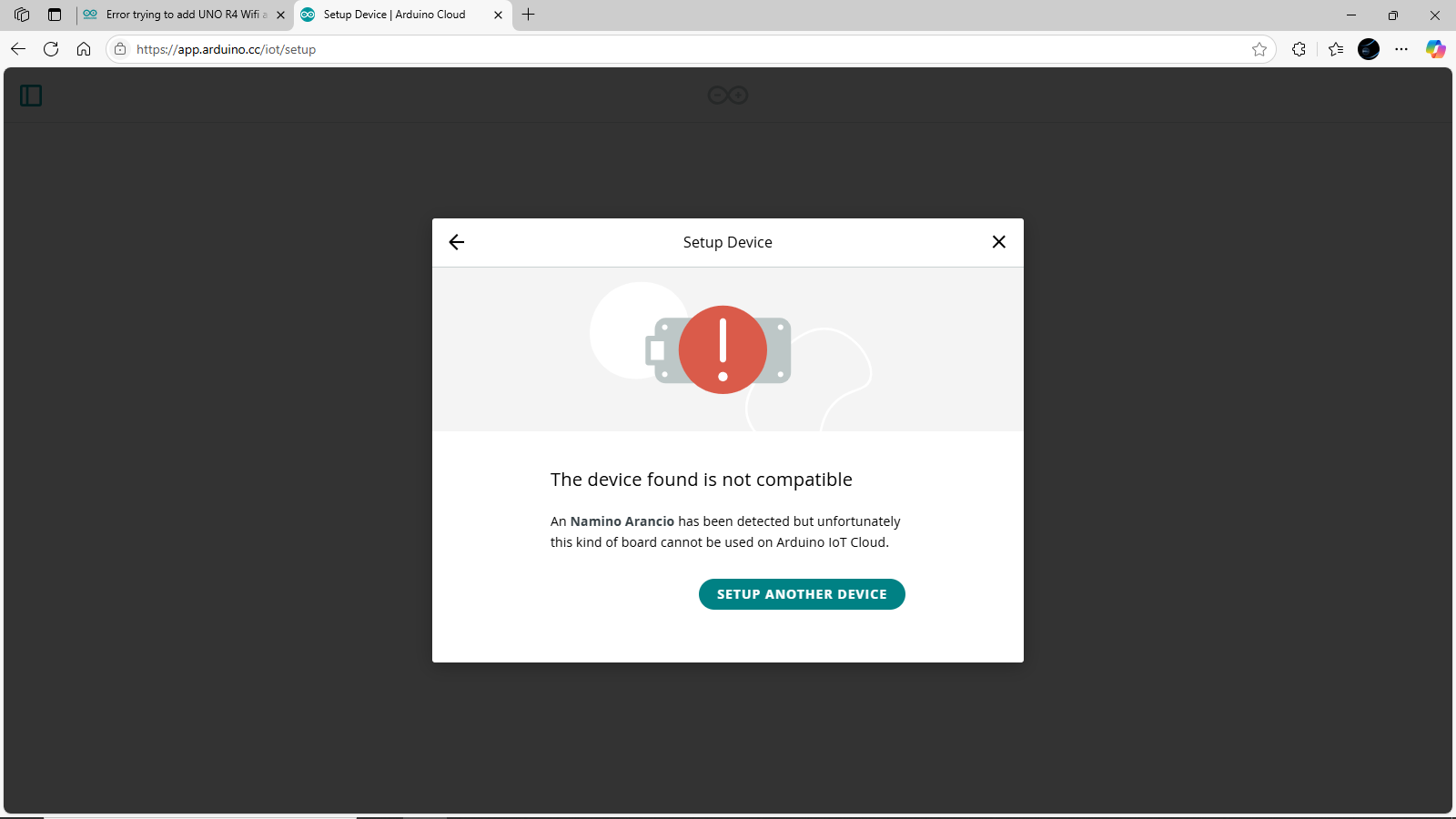

I am trying to add my Uno R4 Wifi to the IoT cloud. When it tries to setup the device I get the following error
"The device found is not compatible
An TAMC Termod S3 has been detected but unfortunately this kind of board cannot be used on Arduino IoT Cloud."
Now I just tried it again and get same error but thinks it is yet a different board:
Hi @mklosterman1. The Wi-Fi communication capabilities of the UNO R4 WiFi board are provided by a dedicated ESP32-S3-based module that is running a custom firmware created by Arduino. When you create an Arduino Cloud IoT Device with an UNO R4 WiFi board, Arduino Cloud checks the version of firmware on the board's Wi-Fi module. If a newer version of the firmware is available, it automatically updates the firmware. The board is put into a special mode in order to allow the firmware update. While in this mode, the board will be identified as a random ESP32-based board instead of as an UNO R4 WiFi. The board remains in that mode even after the update is completed, so it is necessary to power cycle the board to put it back into the normal operating mode.
Arduino Cloud is designed to show instructions for power cycling the board, so I'm not sure why you ended up encountering this problem. Hopefully it can be easily solved though:
  1. Disconnect the USB cable from your UNO R4 WiFi board.
  2. Connect the USB cable to your UNO R4 WiFi board.
  3. Try creating an Arduino Cloud IoT Device from the UNO R4 WiFi board again, just as you did before when you encountered this error.
Please let us know if you have any questions or problems while following those instructions.

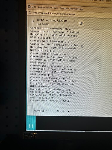

Ok so the serial monitor shows that the connection failed (see attached)

OK, we can see that the board is not able to connect to your Wi-Fi access point.
Please check the two following things:
Does the Wi-Fi access point with SSID "Astroturf" use the 2.4 GHz band? The UNO R4 WiFi board can only be used with 2.4 GHz band access points. It is expected that it will fail if you attempt to use it with a 5 GHz band access point.
If the access point is 2.4 GHz, try setting the password for the access point again in case you typed it in wrong when you set up the Thing. You can do that by:
  1. Open the Thing in Arduino Cloud.
  2. Selecting the "Setup" tab at the top of the Arduino Cloud page.
  3. Click the "Change" button under the "Network" section of the page.
    The "Configure network" dialog will open.
  4. Type the Wi-Fi access point's password in the "Password" field of the dialog.
  5. Click the "SAVE" button in the dialog.
    The "Configure network" dialog will close.
  6. Select the "Sketch" tab at the top of the Arduino Cloud page.
  7. Upload the Thing sketch to the UNO R4 WiFi board again to update the password it will use when attempting to connect to the "Astroturf" access point.
