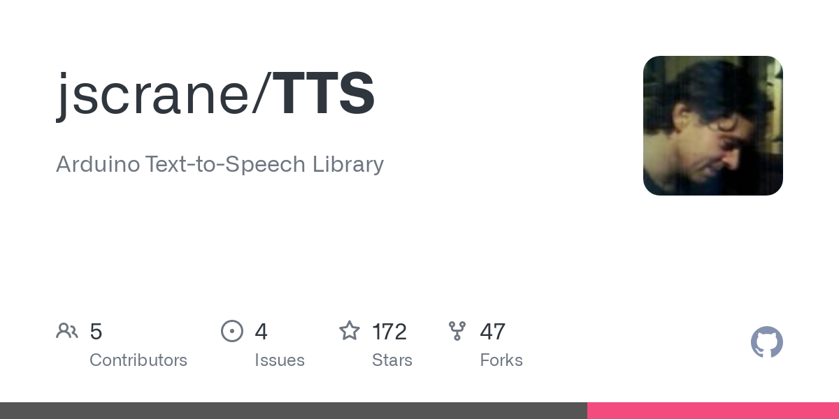

For Adafruit libraries like "Adafruit_LSM9DS1" and "Adafruit_Sensor" the easy way is to use Library Manager (Tools -> Manage Libraries...) to install them. For "english", "sound", and "TTS" you may need to find the library and install it manually. Often you would download a .zip file containing the .h and .cpp files and use Sketch -> Include Library -> Add .ZIP Library to install it.
It looks like the library for "TTS.h", "english.h", and "sound.h" is:
Click on the "Code" button and select "Download ZIP".
