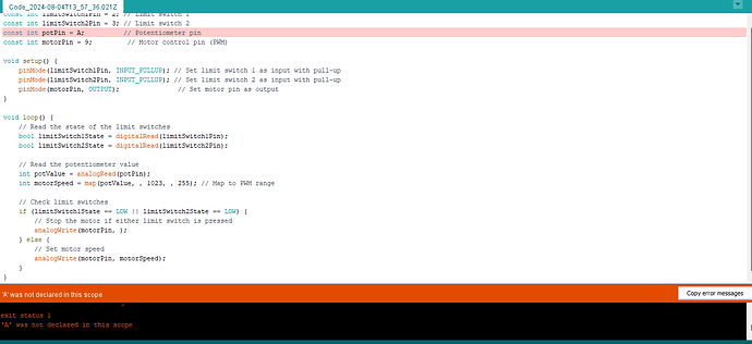

keep getting this error. can someone figure this out so i can upload this code to my arduino uno rev 3

The problem that generates the error you posted is the fact that "A" is not defined anywhere. Most probably you copied or edited the code and forgot another letter. "A0" was probably the correct choice (it is the analog pin A0 of the Arduino).

The error (highlighted in pink/red) is you are missing the number after A. Look on your board where you have the pot connected and you will see A# OR A##. Change the A to that.

Brazilian you are correct I added the 0 after A and it took me to an error on motor speed pot value. So I guess there's several problems with this code.

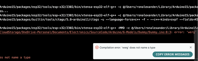

If you want to continue, Post the version of the code and it's associated error(s). Use a for the code, and ALSO for the errors. You can copy the errors using the COPY ERROR MESSAGES lower right. See pic.
Does that help you move forward?

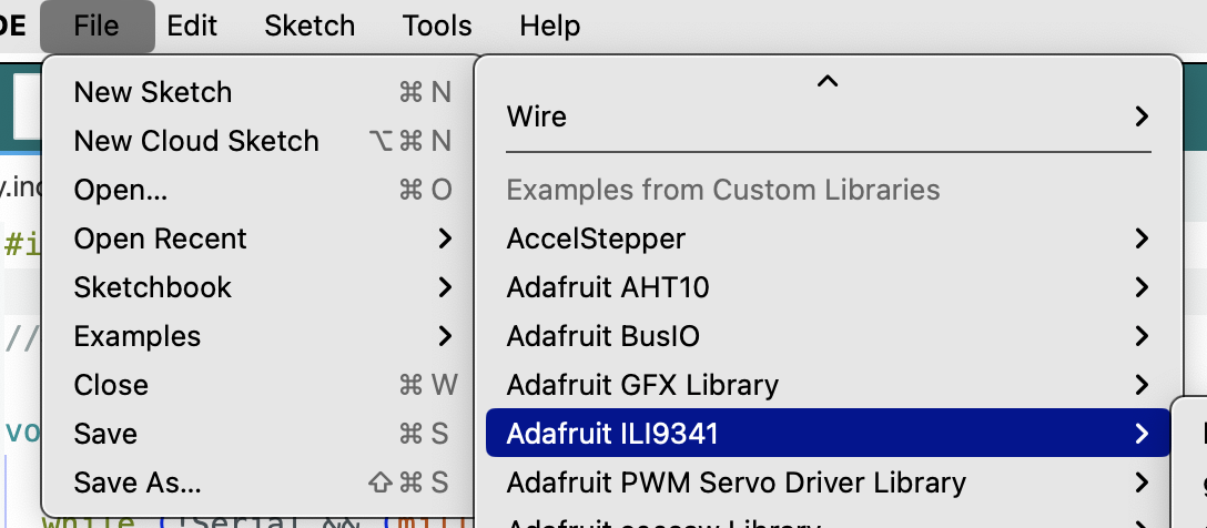

It appears you want to do something with motors of some sort. You are probably using a library. Look at some/all of the library examples and read the code and make notes to get a basic understanding. Pick the example closest to what you want to do and make a copy then start modifying it. I have 50+ years experience with code and still do that quite a bit. Here is how you find the samples (2 ways)
  1. Using the Library search bar find the library you are using, click the 3 dots (you have to move mouse to the entry) then click Examples (see pic)
The other way(harder) is to peruse the File/Example etc, see 2nd pic.
Give that a try and get back to us.

  • look at the lower part of the screen th error is: 'A was not declared in this scope'
  • look at the upper part of the screen the pink line you have: potPin = A; ( as said before A is undefined, define the pin number 'in numbers' )
