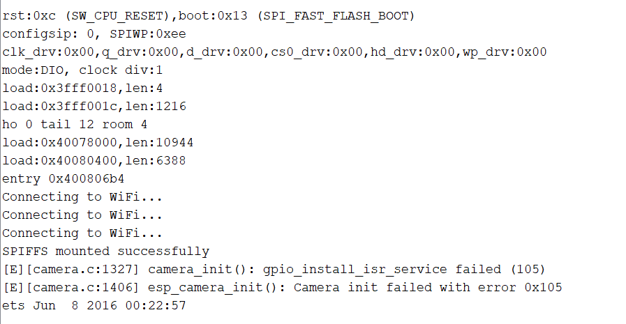

Error when trying to get both location and data using esp32 cam
What I am trying to do is whenever PIR sensor detects a motion, I want the esp32 cam to take a picture. Also GPS module(Neo-6m) should capture the location. The picture should be uploaded to firebase storage. But there is an error happening every time. I will share the code and the error.

Error
Beginner looking for help :slight_smile:
It seems that your hardware configuration is wrong.
Post a link to the library you're using!
have you had the camera, PIR and GPS working by themselves in seperate programs?
