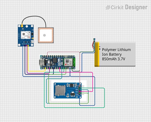

Hello every one. I am trying to interface an sd card with arduino Nano ESP32. The SD card is intitalising successfully but but mounting is failing due to 'Timeout waiting for response' error. I am using sdcard.py library.
The circuit diagram and code is attached below:

The obvious, does the card work in another reader? Is it formatted with right filesystem?
Yes I can read the card in my laptop and it is formatted to FAT32
Not so many ideas left, but one - if you got another microcontroller, wire up the reader to that, see if it initialize and mounts. Just to verify that the card reader works.
@ledsyn are you using the pin numbering from the Nano ESP 32 pin out diagram
if you type
from machine import SPI
SPI(1)
it will show the default SPI(1) hardware parameters including the pin numbers
SPI(id=1, baudrate=500000, polarity=0, phase=0, bits=8, firstbit=0, sck=48, mosi=38, miso=47)
EDIT we are looking at the GPIO numbering on the yellow tabs

There are a couple of ways to use an SD card in micropython here is one way without importing SPI and using the in built SDCard module.
# Format a micro SD card and copy a small text file to the card before using this test code
# Nano ESP32 SPI connections MOSI=38 MISO=47 SCK=48 CS=5
# Adapter connections DI=MOSI DO=MISO SCLK=SCK CS=CS GND=GND 3.3v=3.3v

If you intend to run a SD card and also other SPI peripherals like a TFT screen for example you probably need Peter Hinch's sdcard module, which it looks like you already have. The initialization would be as simple as the following
from machine import Pin,SPI
import sdcard
cs = Pin(5, Pin.OUT, value=1)
sd = sdcard.SDCard(SPI(1), cs)
vfs=os.VfsFat(sd)
os.mount(sd,'/sd')
Your SDcard module includes level translation to allow a 5V board to be used with the 3.3V uSD card.
Could you explain the logic behind using that module with a 3.3V board that does not require such level translation?
