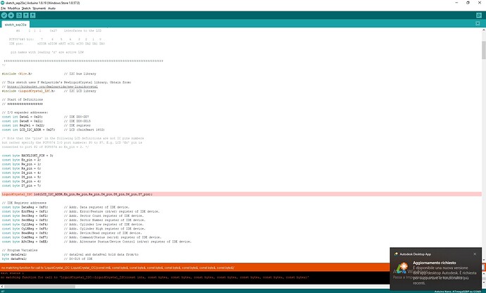

Errore compilazione Sketch ATmega328P
Salve a tutti.
Qualcuno può aiutarmi.
Premetto che sono un principiante dunque non sono un programmatore.
Oggi ho tentato di fare una "verifica" Sketch per arduino ed esce questo errore di compilazione:
Arduino:1.8.19 (Windows Store 1.8.57.0) (Windows 10), Scheda:"Arduino Nano, ATmega328P"

sketch_sep20a:67:84: error: no matching function for call to 'LiquidCrystal_I2C::LiquidCrystal_I2C(const int&, const byte&, const byte&, const byte&, const byte&, const byte&, const byte&, const byte&)'
 LiquidCrystal_I2C lcd(LCD_I2C_ADDR,En_pin,Rw_pin,Rs_pin,D4_pin,D5_pin,D6_pin,D7_pin);
In file included from C:\Users\winter\Documents\Arduino\sketch_sep20a\sketch_sep20a.ino:43:0:
C:\Users\winter\Documents\Arduino\libraries\LiquidCrystal_I2C/LiquidCrystal_I2C.h:57:3: note: candidate: LiquidCrystal_I2C::LiquidCrystal_I2C(uint8_t, uint8_t, uint8_t)
   LiquidCrystal_I2C(uint8_t lcd_Addr,uint8_t lcd_cols,uint8_t lcd_rows);
C:\Users\winter\Documents\Arduino\libraries\LiquidCrystal_I2C/LiquidCrystal_I2C.h:57:3: note:   candidate expects 3 arguments, 8 provided
C:\Users\winter\Documents\Arduino\libraries\LiquidCrystal_I2C/LiquidCrystal_I2C.h:55:7: note: candidate: constexpr LiquidCrystal_I2C::LiquidCrystal_I2C(const LiquidCrystal_I2C&)
 class LiquidCrystal_I2C : public Print {
C:\Users\winter\Documents\Arduino\libraries\LiquidCrystal_I2C/LiquidCrystal_I2C.h:55:7: note:   candidate expects 1 argument, 8 provided
C:\Users\winter\Documents\Arduino\libraries\LiquidCrystal_I2C/LiquidCrystal_I2C.h:55:7: note: candidate: constexpr LiquidCrystal_I2C::LiquidCrystal_I2C(LiquidCrystal_I2C&&)
C:\Users\winter\Documents\Arduino\sketch_sep20a\sketch_sep20a.ino: In function 'void setup()':
sketch_sep20a:143:7: error: 'class LiquidCrystal_I2C' has no member named 'setBacklightPin'; did you mean 'setBacklight'?
   lcd.setBacklightPin(BACKLIGHT_PIN,POSITIVE);
       setBacklight
sketch_sep20a:143:37: error: 'POSITIVE' was not declared in this scope
Uso la libreria Wire alla versione 1.0 nella cartella: C:\Users\winter\Documents\ArduinoData\packages\arduino\hardware\avr\1.8.4\libraries\Wire
Uso la libreria LiquidCrystal_I2C alla versione 1.1.2 nella cartella: C:\Users\winter\Documents\Arduino\libraries\LiquidCrystal_I2C
exit status 1

Detto questo ... della libreria "LiquidCrystal_I2C" ne esistono infinite versioni, con più o meno errori, più o meno compatibili l'una con l'altra e, se tu cerchi di compilare un codice con una libreria di versione diversa ... possono capitare certi errori.
Ti do un consiglio, invece di quella usa questa che ti allego: PCF8574_HD44780_I2C.zip (522.4 KB), è ben manutenuta, ha un suo thread qui sul forum Italiano, la trovi anche su GitHub e funziona bene ... i metodi sono più o meno gli stessi della LiquidCrystal_I2C ... studiati gli esempi a corredo per il corretto uso. :wink:

per quanto riguarda la libreia che mi hai consigliato di usare, mi sai cortesemente dire come faccio a caricarla in arduino?
Scompatta il .zip e copi tutta la cartella che estrai nella tua cartella delle librerie utente. La cartella delle librerie utente (libraries) è dove hai definito il percorso del tuo "sketchbook" (nelle preferenze del IDE) :wink:
Poi rilanci l'IDE e la trovi tra le librerie disponibili e tra gli esempi :slight_smile:
