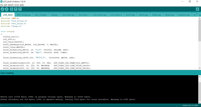

I gave it a go just now, and the example sketch you're talking about appears to build fine on my machine.
In case it isn't clear in the initial instructions you were given, the code you posted is just a small part of the program; there's a lot of other files that go along with it. If you copied and pasted just that section on its own, it won't do much.
If you haven't already, go check out the instructions at https://www.waveshare.com/wiki/2inch_LCD_Module#Arduino_Software_Description
You should download and extract the .7z archive, then go to the folder for LCD_2inch, and open the LCD_2inch.ino sketch from right there in the folder.
You should be able to see all those extra files as tabs along the top of your window.
