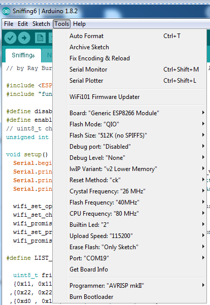

this is the setting I have on the arduino IDE
(as I remember)
is this good?
I'm connecting to the ESP-07 with USB-FTDI cable
Port is greyed out. That tells you there's no connection between computer and USB adapter.
I know , I print the screen without connecting the cable
I have connected the cable now -
And all other setting are OK?
Should be fine. As long as your device is in program mode it should accept the upload.
