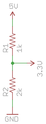

just the GND, not the 5V.
of course the resistors have to be set up correctly as a voltage divider

Post #22 is suggesting something like Fig-1 using resistors for level shifting of logic signal.
Figure-1:

Wait looking from the Mega TX after the first resistor are there a cable that goes to the ESP RX and another resistor that goes between the 2 GNDs?
well that second resistor is what makes the voltage divider, you take the 3.3V in between and the other resistor does go to GND, yes.
voltage-divider-circuit
As you've GND just underneath in the drawing, that's why @GolamMostafa connected it there.

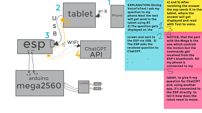

Hi!
I was working on this project, I'll show you a hand drawn with all the parts and what happens.
Problem is at point 2:
When I send the data from the tablet with serial comm. it reads something else and the answer from ChatGPT is a simple " I am an Ai language model and I cannot provide any information or response without contest to your letter (and sometimes it says the number 119 or 111)
I even tried from my pc and it's the same but when I directly type the question into the code it works fine...
This is the code that takes the question from the serial and doesn't work:

Thank you
Wow! Thank you for the fast answer! I knew there was something wrong with that serial. I'll read about it and let you know.
