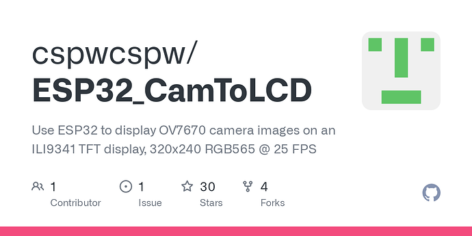

After comes a new idea, i have found a older project:
This project use a OV7670 camera, what can be connected to the esp32 board.
