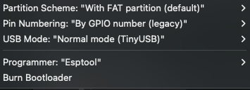

I tried to change the basic options on IDE - Tools (see screenshot):
FAT and SPIFFS partitions don't seem to make any change
Screenshot 2025-02-07 at 14.44.16
GPIO or Arduino pin numbering could make the difference I guess, but if I set it to Arduino the program doesn't get compiled.

So far, the only way to get the control surface sketch running is by selecting the ESP32-S3 Dev Module board with the settings attached below. However, it is very temperamental: it runs for a few minutes and then freezes, after which it no longer works—even if I unplug and reconnect the USB cable, press the reset button, or plug it into another computer. Sometimes, changing the USB cable may temporarily resolve the issue.
