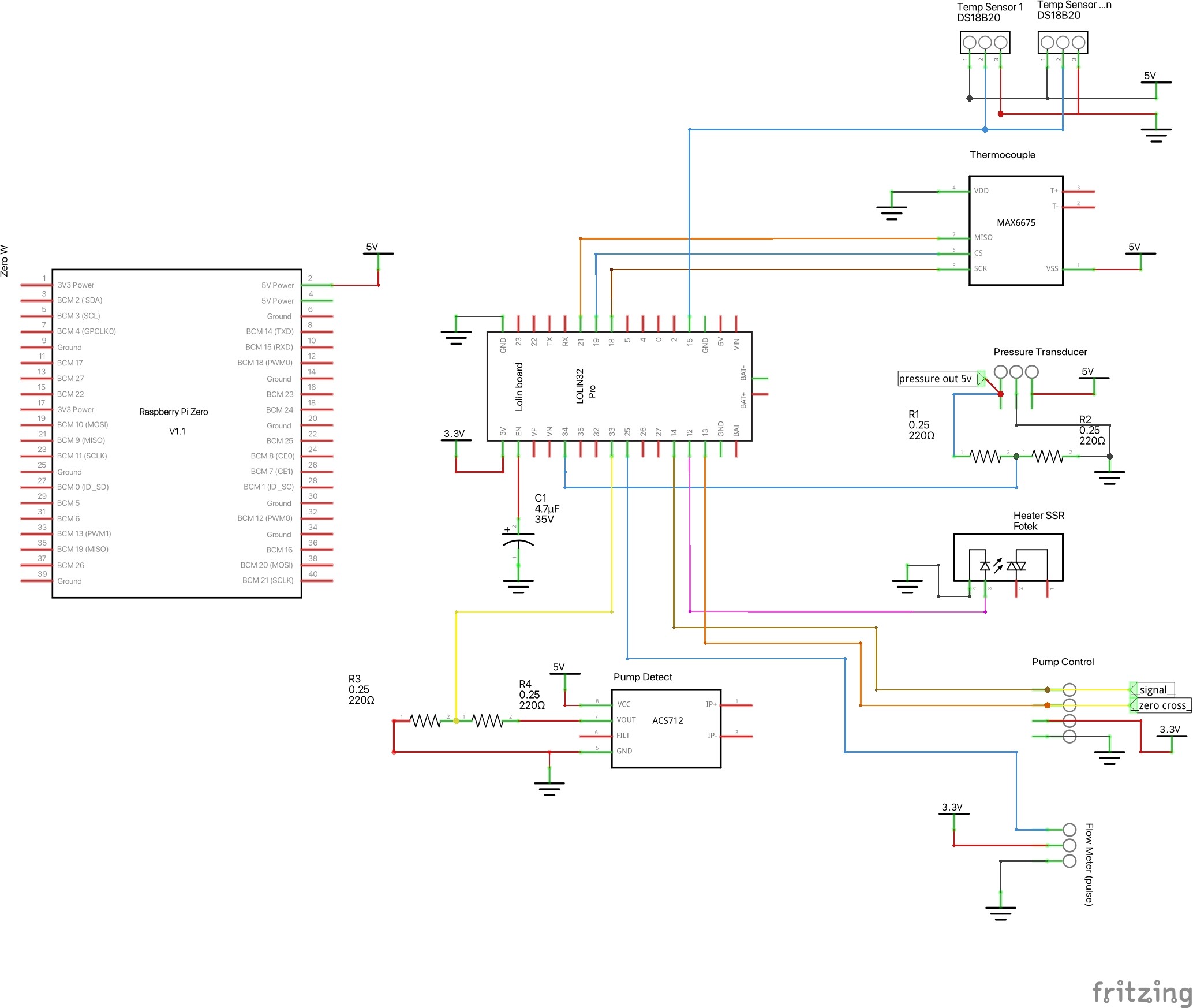

then when I connect it to the sensor (pressure transducer) via voltage divider (the sensor is 5v) I get values like the ones above
yesterday it showed proper values. today out of the blue started acting erratically and settled on these values.

Ok, so your problem might be reformulated as "I get ADC readings from my pressure transducer that I do not understand. How come?"
Can you post information about the transducer and a full schematic of your setup?
the pressure transducer is the typical sensor returning proportional voltage. I'll set-up test bench with voltage dividers so I know what values I get and check it properly.
That sounds easy enough to interface with.
yes and I have it working and then suddenly it goes off counting non-existent pulses with frequency same as the next pwm pin or just being erratic. when I change the board this goes away. Therefore I'm asking for advise how to check if I have damaged my board.

Similarly, if a hardware issue underlies this issue, a schematic would be useful.

here is the diagram
The ESP32 is a 3.3V device, putting more than 3.3V on the GPIO pins fracks the ESP32.
Consider. Voltage Divider Calculator (ohmslawcalculator.com) R2 should be 10K. Input volts is 5.
thanks, I've used divider calculator. these are actually not the real values. However big thanks for pointing this out because I went to measure the real values (I forgot what I put) and realised there's a problem and the voltage goes above 3.9v. I've made some mistake when soldering...
I think you should read this: Page not Found - ESP32 - — ESP-IDF Programming Guide latest documentation
It seems you assume can read up to 3.3V with the ESP ADC but AFAIK you can't.
Thanks. I did and I understand by default biggest attenuation is configured, therefore max of 2.45v should be OK?
By design pressure was always under the max range of the sensor so I never expected to hit 3v anyway. But as I realised I've wired my voltage divider wrongly. The data I got made sense (until I didn't) so I never double checked with the multimeter. Rookie mistake.
