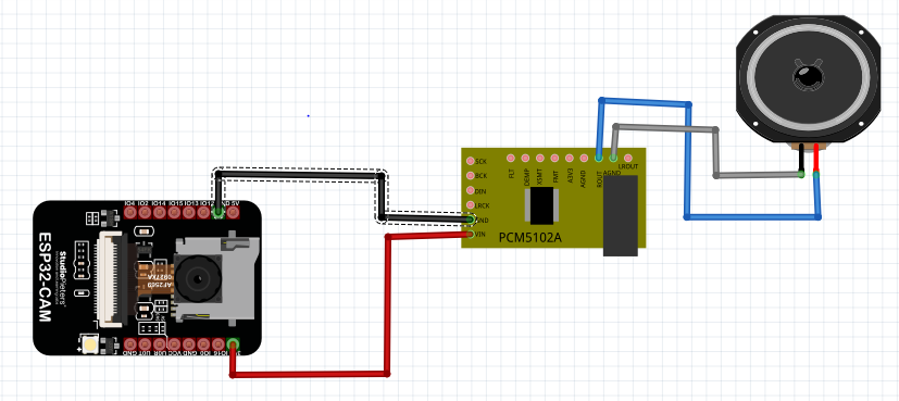

Please post a schematic of your project and your best effort at paying a sound file. Describe what problems that you have had
@UKHeliBob ,
thanks a lot for your answer.
This is my configuration.
This means I use the I2S interface on the ESP32-CAM to the PCM5102 board.
I got a example but it doesn't work (compiling errors)

Now I want to test the whole thing and I still need to know which pins can be used on the ESP32-CAM board.
It's a bit unclear to me which pins on the ESP32-CAM board have which function.
I use a PCM1502 DAC to connect a digital output.
Some pins are already occupied by the camera and the SD card reader.
I know that I have to connect the DAC to the 3.3V. The ground is also clear.
Which pins can I use?
