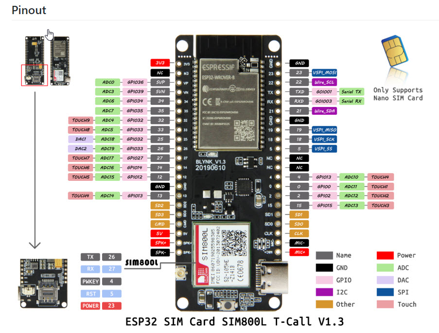

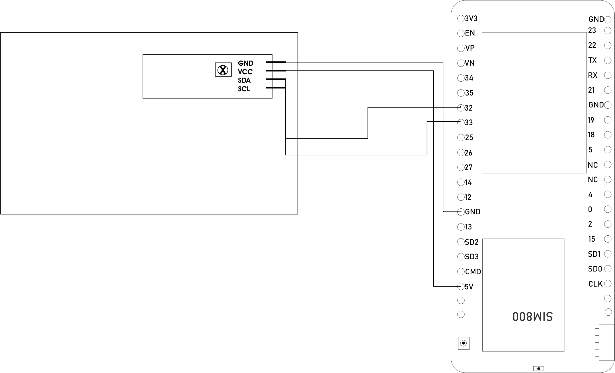

In the code I have used a ttgo tcall module with sim 800l on it so the project is about measuring voltages of 4 gpioo pins and sending the data through sms due to unavailability of internet.
Everything is working just problem is happening in the i2c Part
The i2c pins for power management ic ip5306 is set to SDA- 21
and SCL-22 . And a 20*4 lcd is set to SDA-33 and SCL-32 when I am removing the i2c of ip5306 the lcd works fine and if ip5406 is included lcd stops working . Even the lcd address is 0x26 and the ic is 0x72 still encountering problems . I would be thankful if someone helps me (I am not going to deeper explanations for it would become too long)

As the I2C devices have different slave addresses, you can connect them in parallel with the same I2C Bus -- (SDA-21/SCL-22).
Yes I have tried this like setting only one definitions
#define Sda  21
#define Scl    22
Am I doing this right

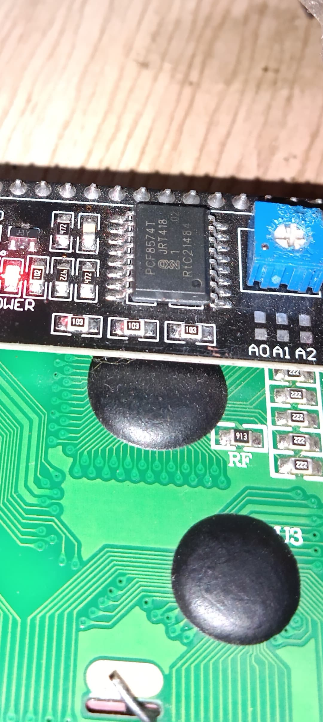

Does IP5406 device work alone on the I2C Bus (SDA/SCL=21/22) without LCD?
Yes it is now solved I think maybe the previous address of the lcd 0x27 (sda-21 scl-22)was interfering with the address of the ip5306 's 0x72 address now I tried changing the address of the lcd .....
By following this chart I got that the 0x3F address is not suitable for my own ic so if it is 0x27 then
Shorting the A2 pins should give 0x23 as the address..so I didSet the address as 0x23 for the lcd. Now the lcd works fine . Thanks(Golam Mostofa) for giving the point of setting the two I2C at parallel connection.
