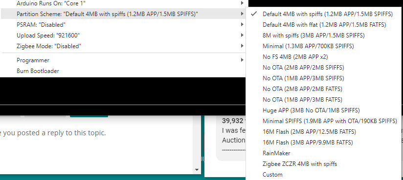

Which partition scheme have you got selected in the IDE ?

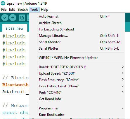

I can't find partition schema in my tools menu
No for the DOIT devkit it doesn't have it in the esp32 core.
What board do you have exactly (link from vendor please) Since it probably uses an ESP32-WROOM you can most likely use the more generic 'ESP32 Dev Module' with which you can select a partition scheme.

I have found the solution by setting the partition scheme. Thank you very much for the helps and advices.
And how did you do that?
In the IDE Tools menu
Setting the board to "ESP32 Dev Module" enabled these tool menu options.
