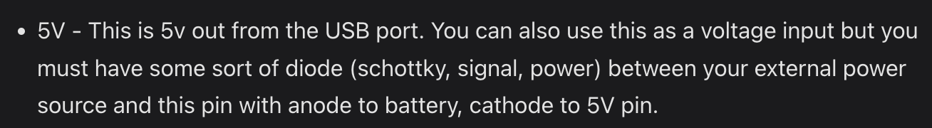

I dont see VIN pin in here.....

Screenshot 2024-12-31 at 03.41.17

thanks, i'll try this later
