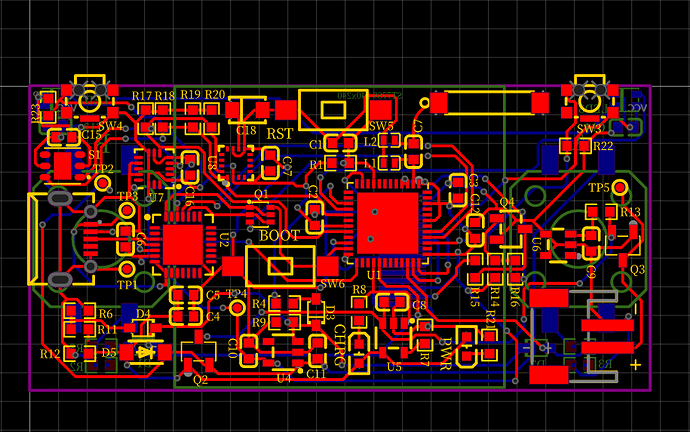

I made a testbed for this ESP32. Everything is fine until it comes to connectivity. WiFi scan example throws burnout. So it is the power issue.
According to this schematic, I used the right capacitors on the power rail. That means 100nF and 10uF.
As it works stable at blinking LED, etc, it obviously doesn't work as it should when there is some bigger current draw. I used 0603 caps, not sure of tolerance. It might be a problem with their position. 10uF cap is close to pin 46 (VDDA) and 100nF is close to pin 19 (VDD3P3_RTC). Yeah, I know, this last I did by mistake. Maybe I should take this one and put it on top of the 10uF. But is it the right place at all?
What should be the best solution for power rails, caps, etc, to avoid these current issues?

This is the PCB.
It will be rearranged, of course.
Selection_058
Sorry, but everything I see there is a total RF design disaster! :astonished: :grimacing: :sob:
There are tracks running under C7, the end of the antenna is next to SW3, there is a long track running from I.1 and I.2 - whatever they are - to somewhere else, a blue track parallel to the antenna and the antenna is located within the PCB outline.
None of these components must be anywhere near C7 and the antenna, and the track between the ESP and the antenna must be correctly designed with the correct PCB material and rear groundplane with correct ground "thrus".
No wonder the WiFi does not work! :roll_eyes:

Are L1/L2 directly connected to a ground plane. If not, then the Pi filter won't work as intended.

There is no ground plane. I can make a revision or shorten the GND path with a wire if that will do any good.

"anywhere near" meaning within about 1 wavelength which is 12.5 cm.
In other words, there must be a plane - an effective flat surface - from which the antenna projects, which is clear of all obstructions. Any encroachment will degrade the performance and if sufficiently degraded, will reflect most or all of the power back into the transmitter as you have experienced.
A good example of an antenna design is the little whip projecting up from the roof of a car.
