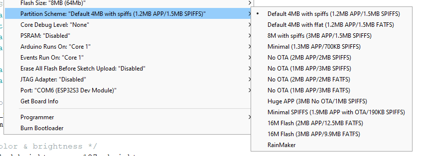

what kind partition scheme are you using is it space allocated for OTA. What code are you using for OTA

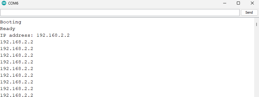

I'm using the default 4MB partition. I've been doing my testing on the default OTA sketch as a test. I've confirmed my ESP32 is connected to WiFi, as I'm getting an IP Address readout.
Can you share the code and output shown in the serial monitor
#include <WiFi.h>
#include <ESPmDNS.h>
#include <WiFiUdp.h>
#include <ArduinoOTA.h>
const char* ssid = "Kame House - 2.4GHz";
const char* password = "WeGott@P0wer!";
  Serial.println("Booting");
  WiFi.mode(WIFI_STA);
  WiFi.begin(ssid, password);
  while (WiFi.waitForConnectResult() != WL_CONNECTED) {
    Serial.println("Connection Failed! Rebooting...");
    delay(5000);
    ESP.restart();
  // Port defaults to 3232
  // ArduinoOTA.setPort(3232);
  // Hostname defaults to esp3232-[MAC]
  // ArduinoOTA.setHostname("myesp32");
  // No authentication by default
  // ArduinoOTA.setPassword("admin");
  // Password can be set with it's md5 value as well
  // MD5(admin) = 21232f297a57a5a743894a0e4a801fc3
  // ArduinoOTA.setPasswordHash("21232f297a57a5a743894a0e4a801fc3");
  ArduinoOTA
    .onStart([]() {
      String type;
      if (ArduinoOTA.getCommand() == U_FLASH)
        type = "sketch";
      else // U_SPIFFS
        type = "filesystem";
      // NOTE: if updating SPIFFS this would be the place to unmount SPIFFS using SPIFFS.end()
      Serial.println("Start updating " + type);
    .onEnd([]() {
      Serial.println("\nEnd");
    .onProgress([](unsigned int progress, unsigned int total) {
      Serial.printf("Progress: %u%%\r", (progress / (total / 100)));
    .onError([](ota_error_t error) {
      Serial.printf("Error[%u]: ", error);
      if (error == OTA_AUTH_ERROR) Serial.println("Auth Failed");
      else if (error == OTA_BEGIN_ERROR) Serial.println("Begin Failed");
      else if (error == OTA_CONNECT_ERROR) Serial.println("Connect Failed");
      else if (error == OTA_RECEIVE_ERROR) Serial.println("Receive Failed");
      else if (error == OTA_END_ERROR) Serial.println("End Failed");
  ArduinoOTA.begin();
  Serial.println("Ready");
  Serial.print("IP address: ");
  ArduinoOTA.handle();
