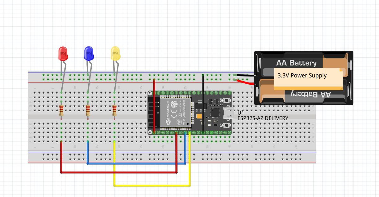

I'm quite new to ESP32 development. I've been using this devkit for a few small projects and everything was going smoothly until I decided to run it on battery. In particular, the ESP32 devkit I'm using, when connected to a battery, seems to have issues when trying to connect to the Wifi.
I'm using a 9V battery connected to a MB-V2 power supply to convert the output voltage to 3.3.V. The power supply board has the following specifics:
  • Input voltage: 6.5-9v (DC) via 5.5mm x 2.1mm plug
  • Output voltage: 3.3V/5v
  • Maximum output current: 700 mA
  • Independent control rail output: 0v, 3.3v, 5v to breadboard
As you can see in the picture, my multimeter measures an output voltage of about 3.3V
I built a sample project for debugging, here's the schematics:
The battery is connected to the power supply which outputs 3.3V and powers the ESP32 through its 3.3V pin. I don't have a schematic for this specific devkit I'm using so the devkit used in the schematics is the DOIT one, hence all of the pins are off. The code is quite simple, though, so it hopefully can clear things a bit:

In the code, the ESP32 first lights up all LEDs, then it lights up the red LED while it tries to connect to the Wifi. After at most 10 secs, it lights up the yellow LED if it successfully connected, otherwise it lights up the blue LED. Also, as a last thing I send the ESP32 into deep sleep, as my intention was to measure its power consumption during sleep.
When connected to the PC, everything runs smoothly, while when connected to the battery the ESP32 (apparently) never exits the while loop and the red LED stays always on. The RED led then starts flickering and the power LED start blinking. Resetting it throught the RST button on the devkit causes the power LED to start blinking and the red LED never lights up. This continues until I cut off the power, then the code seems to start again from the beginning (i.e. the startup sequence) and the this behavior repeats.
I've read a few posts about similar issues with ESP32 devkits, but the problem was always about batteries not having high enough voltage, which doesn't seem to be my case. What could be causing the issue?
That PP3 battery is going to last no time at all when supplying the required current to your project. Have you measured the battery and supply voltages under load ?

Thanks for answering! I am aware that the battery won't hold for long, but I figure I could use it at least for testing the full project. This is the first time for me using a battery to power a project, so I've no idea of what I could be doing wrong.
I can't test the load when connected to the Wifi, since the code won't run, so I tried measuring the load for this simple code

I then inserted my multimeter between the power supply and the board, in order to measure voltage and current, here the outcomes:
Voltage (under load): 3.3V
Current (under load): 48-53 mA (oscillates)
Which battery would you suggest?

I would like to go at least 3-4 weeks without reloading. I've yet to measure the power consumption under load with the Wifi working, but the problem is that the only devices that I got that can power the Wifi use a USB cable and I've no idea of how to measure current with a multimeter when using the USB. Is there a way?
For now, the only measurement I got are 48-53 mA in active mode (without Wifi) and 9 mA while in deep sleep.
Anyway, I have a 10000 mAh power bank with a USB cable, it did the trick! Everything works fine, I had no clues it was actually the battery. The only issue is that now I have no idea on how to measure the current using my multimeter while powering the ESP32 with a USB cable.
