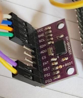

Hello everyone,
I’m working on a VR project and need help getting sensor data from the BNO08x using an ESP32 Dev Board over I²C.
:wrench: Hardware I’m Using:
  1. BNO08x IMU (GY-BNO080/BNO085 breakout)
    :link: Amazon Link
    9DOF AHRS sensor, supports quaternion output and sensor fusion.
  2. ESP32 WROOM-32 Dev Board by OceanLabz
    :link: Amazon Link
    Dual-core WiFi + Bluetooth module, USB-C with CP2102 chip.
:puzzle_piece: Goal:
Read accurate Yaw / Pitch / Roll (orientation) data from the BNO08x via I²C using the Adafruit BNO08x library.
:electric_plug: Wiring Connections (I²C Mode)
BNO08x Pin ESP32 Pin Purpose
VIN / VCC 3.3V
GND GND
SDA GPIO 21
SCL GPIO 22
PS0 GND
PS1 GND
ADO Not connected
INT Not connected
RST Not connected
CS Not connected

Despite successful I²C detection at 0x4B, the output is fails with this error:
❌ BNO08x not found at 0x4B
:red_question_mark: What I Need Help With
  • Is the connection wrong ?
  • Is the hardware wrong ?
  • Or anything else ?

You could try if you have better luck with sparkfun library examples.
Try address 0x4A instead.
I just checked an example from Adafruit and it has
#define BNO08x_I2CADDR_DEFAULT 0x4A ///< The default I2C address
Since the sensor at the link showed a separate PCB and header, and because so many people fail to do this, I have to ask: is that header soldered to the sensor PCB?
is this in the .h library where should i change because if you were asking to change in code that i did and it is showing the same error
yes i have soldered the header to the pcb
It is in the sample code in the .ino file. I think you have 0x4B, it should be 0x4A. Just do a global search if you don't see it near the top of the file.
hii , i have tried it using 0x4A in the sketch as well it didn't worked accordingly though
Is your issue "module not detected?"
yess i am thinking it because of hardware issue so is the reason asking suggestions on which to buy

Hi, I am using the same GY-BNO080 / BNO08x sensor with an ESP32.
Just sharing what worked for me:
  • I did not connect PS0 or PS1.
  • Only pins I connected: VCC, GND, SDA, SCL
  • Sensor works fine with default I2C settings.
