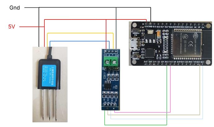

ESP32 WROOM 32, NPK sensor and TTL to RS485 Program issue
ok I'll share the connection
Initially, i had an issue with the baudrate as i set it to 9600 and was getting raw data, i later changed it to 4800 and got meaningful values
I'd appreciate it
sensor connection:
:blush:Thank you

Requesting Nitrogen...
Timeout! No response.
Requesting Phosphorous...
Requesting Potassium...
Nitrogen: 255 mg/kg
Phosphorous: 255 mg/kg
Potassium: 255 mg/kg
This is the response that i was getting , could it be because i was using the wrong addresses and registers ?
At first i used the code as is but i was getting raw data which i couldn't understand, then after i changed the line of code :
Serial.begin(115200) to Serial.begin(4800) and i started getting data i could understand

I asked deepseek to extract the inquiry frame for me and used the above code but i'm still facing the same problem :slight_smile:

I have sent you a program along with some information regarding your sensor. You may also try it.
Those canned modbus messages are quite common and they are querying the wrong registers according to the Chinese user manual you provided.
The user manual says that Nitrogen is in register 04h, Phosphorous in 05h and Potassium in 06h. Assuming that you have been given the correct user manual for your NPK sensor, then the three canned modbus messages would be:
const byte nitro[] = {0x01, 0x03, 0x00, 0x04, 0x00, 0x01, 0xC5, 0xCB};
const byte phos[] = {0x01, 0x03, 0x00, 0x05, 0x00, 0x01, 0x94, 0x0B};
const byte pota[] = {0x01, 0x03, 0x00, 0x06, 0x00, 0x01, 0x64, 0x0B};
But those values you get back could be anything and you wouldn't know if they were correct or not.
As a test I would send out this canned modbus message:
const byte temp[] = {0x01, 0x03, 0x00, 0x01, 0x00, 0x01, 0xD5, 0xCA};
If you get a response to that message, then it should be the temperature. Note that a decimal value of 275 needs to be divided by 10 to get 27.5C.
I disagree, even if they are anything, I still know if they are correct or not. :sweat_smile:
How should the sample code for temp look like ?
Because i tried adding temp and i got 255 degrees
