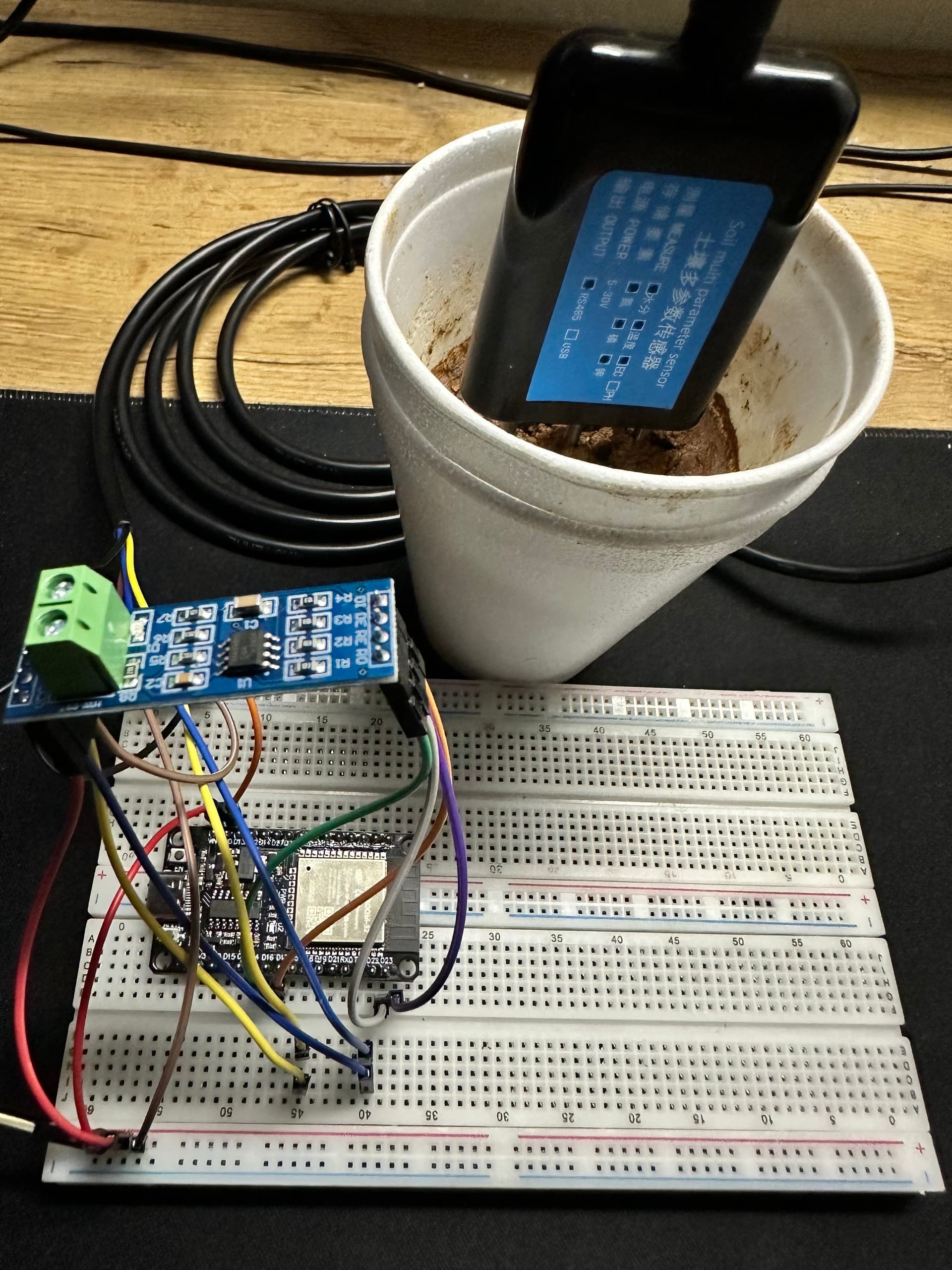

Well i managed to check all the jumper cables and they are all good, I even changed the RS485 module, i tried to switch the A and B connections and tried swap RX2 and TX2 . I'm at a standstill rn and wondering what could be the problem , i was wondering if it could be the Rx and Tx ports i'm using on the ESP 32

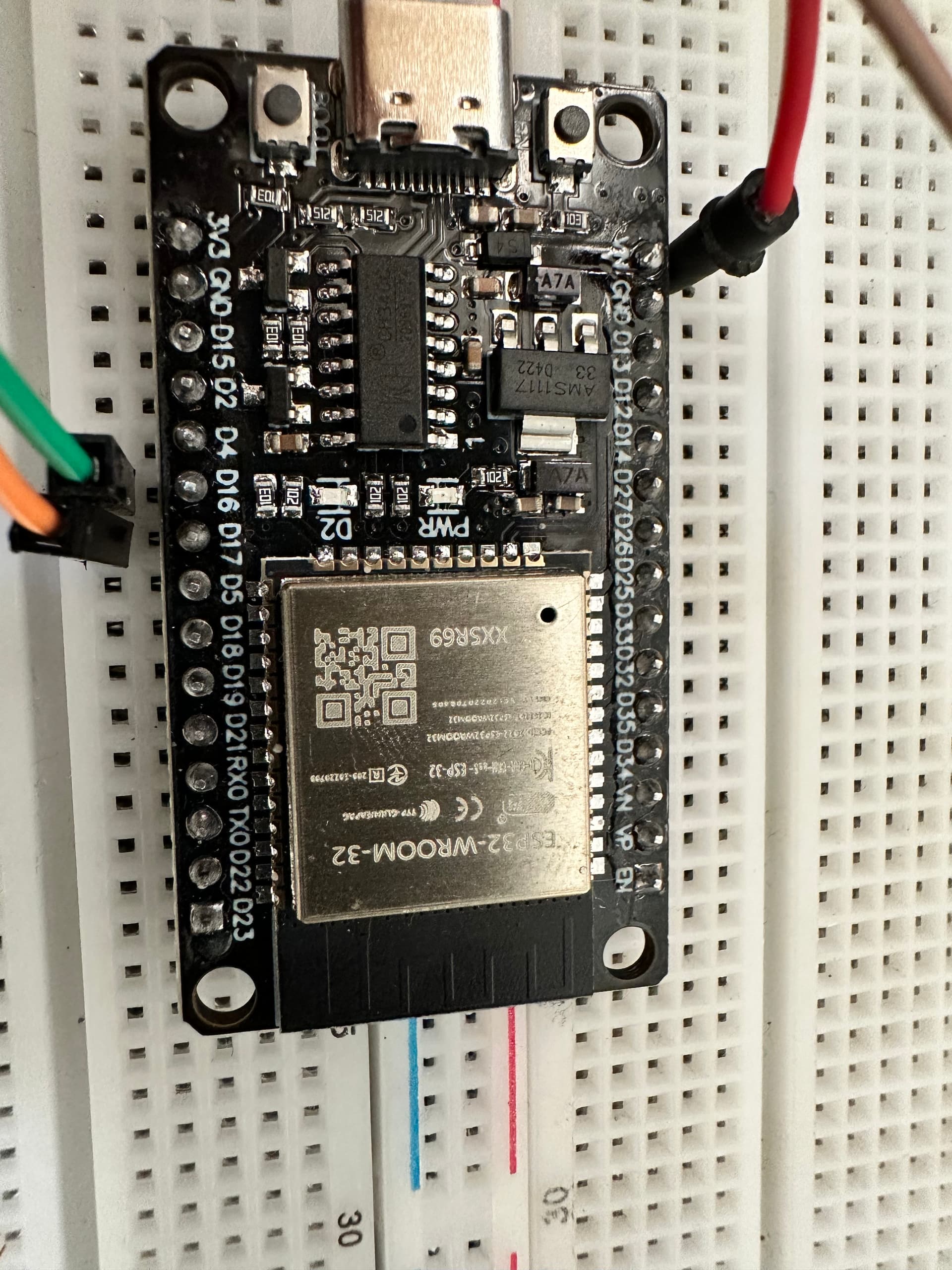

You don't tell what module. I don't see DE/RE wires on your image, but on your code you use them. Neither I see GND.

Post all the components you use, your wiring and actual code.
This was just a pic of the type of ESP32 i'm using,but i'm using all the components from the pic provided by Eva-55

Could you tell me how you are supplying power? Are you providing power separately to each component, or are you just using a USB cable connected to the laptop?
Since i'm in my dorm room right now i'm currently using the 5V power port and the GRD port from an arduino mega but when i'm at the lab i use a power generator set at 5V
Now it's mega, before it was esp32. Rs485 module should be powered at voltage based on your arduino...
Also, you could power the sensor at little higher voltage. It has range of 5-30V, I wouldn't go with absolute minimum.
I think you misunderstood me a bit , the project is using a ESP 32 as the microcontroller and to power the circuit which includes the sensor i was using the 5V power port from an arduino which i have lying around the room . I will definitely try to power the sensor using more voltage to see if i can get some results.
And the RS485 module at operating voltage of your Esp, 3.3V...
Could you please draft a rough drawing on how everything should be connected
