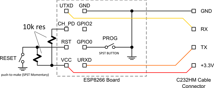

Many people recommend that you need external power supply or have to use a liner regulator of 3.3 volts, which at least I didn't have to use. I had tried to keep the whole thing as simple as possible.
Things and softwares I have used [Done using Windows 8]
A. Hardware
  1. Esp8266 - 01 module
  2. Ftdi usb to serial with 3.3 volt output option [original - otherwise you will waste money]
  3. Jumper cables
  4. Usb to Mini usb cable to Ftdi
  5. 10 uf capacitor
  6. 10 k resistors 2
  7. reset button

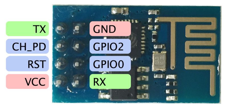

  2. !! Remember when flashing then only connect GPIO-0 TO GROUND. After finishing please remove ground contact from GPIO-0. Power down or use the reset button if the flashing does not work, some times it gives glitches.

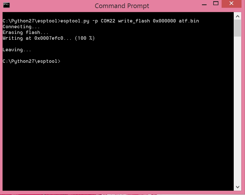

  3. go to the folder using cd and cd.. commands as per needed the destination should look like
    C:\Python27\esptool> esptool.py -p COM20 write_flash 0x000000 fls.bin
    [Note: My ftdi is on com 20 but your can be different, so please change it.
    Changed the name AI-v0.9.5.0 AT.bin to fls.bin]
  4. press enter to start the process of flashing, after finishing disconnect the gpio-0 to ground jumper.

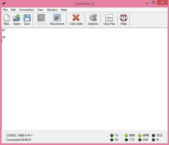

  6. open coolterm window, use 9600 baud rate.
  7. Type AT and you should receive OK.
I have also flashed the Esp 01 module with other firmwares using the same process,
