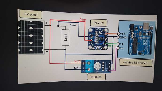

hi I'm doing a school project where i use a Solar Panel that send data to an ESP8266 using INA219 and F031-06 Voltage Sensor; then everything get sent to an database.
the problem is that ESP can't find the INA.
Can someone help me?
thanks.
I' ve used this image as an example:
in LOAD i used a led;
instead of using arduino I've used ESP8266;
instead of using INA169 I've used INA219.

Load and run an I2C Scanner program and see if the INA219 is detected.
The I2C scanner should show the I2C address of all connected i2C devices.

The 2 devices are not properly connected to the controller.
I2C is a 2 wire bus plus common GND is needed.

Please read and consider reply #6.
Please grab pen and paper and draw how the I2C bus is connected. It is incomplete in the Fritzing picture.

That's okey. The first pic didn't look like that.

Do your SDA and SCL lines have pullup resistors anywhere?
i don't know, where do i need to look?
I could and did check that now. It's correct.
Reply #15 ask about pullup resistors. No such in Your schematics.
Not knowing the esp8266 I ask if SDA and SCK are present at the pins You use?
no there aren't, but there's RX and TX

Oops. They are nor ekvivalent, not the same, have nothing in common.
Micro controllers can often be configured, using pins, for different purposes.
I have never used an esp8266..... Check its datasheet, libraries, for esp8266+I2C for the correct pins.
