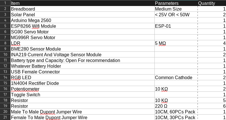

Here are the parts I'm using for my project, i can add comments etc
A convenient approach is to use a servo power distribution PCB, ESPECIALLY with the MG996R servo, which draws 2.5A start/stall current. Breadboards are generally limited to 100-200 mA.

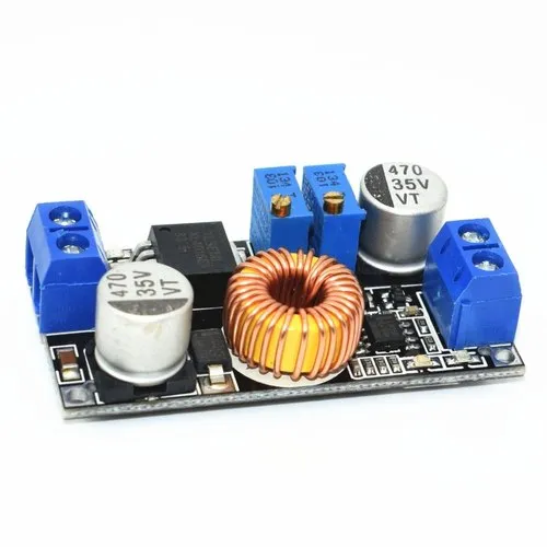

Now, since my project is literally about sun tracking system, it'd kinda counter-intuitive if i wanted to power it from the wall. So, i want the solar panel to power the whole system and then use buck converter to step down the output voltage to 5V and 3.3V for the different components of the system. I hope i made it clear.
Honestly, that part is still open for recommendation but i was considering 12V 3A(since ina219 can't measure more amps) and XL4015 DC to DC Buck Converter to stabilize the output and then any 3s BMS(11 - 12V & ~9Ah) for charging. After that 2 more XL4015 DC to DC Buck, one for 5V and the other for 3.3V.
I chose XL4015 buck converter because it has customizable voltage and amps output.
Let me know where i may be starting a fire. Thanks, buddy.
