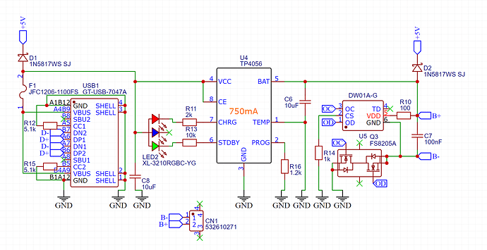

Q3 is part of the second schematic for this PCB that shows the implementation of the TP4056.

I suspected as much. Other than that you did not provide complete information from the very get go, how are you drawing 5v from a LiPo, i mean there must be a buck converter somewhere ? a Lineair regulator is just not going to work ah i see the 6211, well that states in the datasheet Vin = Vout + 1V, so if you want 3.3v for the ESP, you will need 4.3v minimum, and the LiPo will not provide that.
btw, if you have prog at 1.2K that means that you will be charging at the 1A (not at 750mA as stated) and now i see why USB C is required. Are the 1N5817 diode talking care of the load sharing issue ?

Anyway, power wise, a MT3608 is a much better choice to achieve 3.3v from the range input voltage that you have. Admitted that it is more expensive (it's more parts), but even 3v input will result in 3.3v output if you use the proper resistor values.
