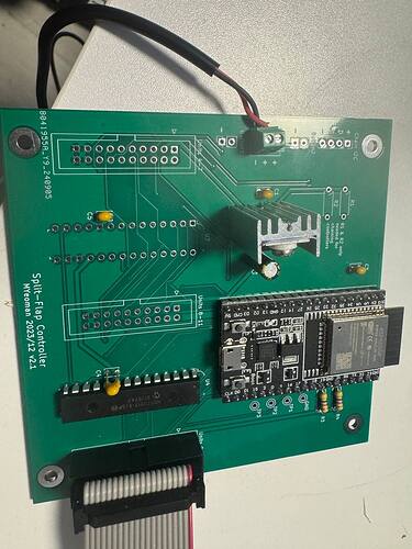

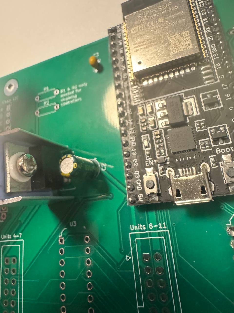

Also can you post a picture of the soldered board, do you have U1 (the TO-220 3.3v regulator in the correct rotation ?
The silkscreen for U1 is a little confusing. Are you sure you have U1 in the right way?
I believe it is, I have only this picture on me, but keep in mind that the rest of the parts have been soldered.
Yes I used a multimeter and I coudl't find any short between vcc and ground
this is how I soldered it
Looks correct.
Is it an LD11173V3 and not a 5V?
3.3 not 5

The designer chose to supply power to the ESP via the 3V3 pin which can cause problems when you also connect the ESP via the USB port.
Do you try to program the ESP while it is connected to this board?
No I usually upload the scripts before to install it.
But after it receive power from the board I can't use it anymore, the ESP32 gets really hot and afterwards if I try to connect it to the USB it doesn't get recognized.
I'm pretty sure they get fried.
