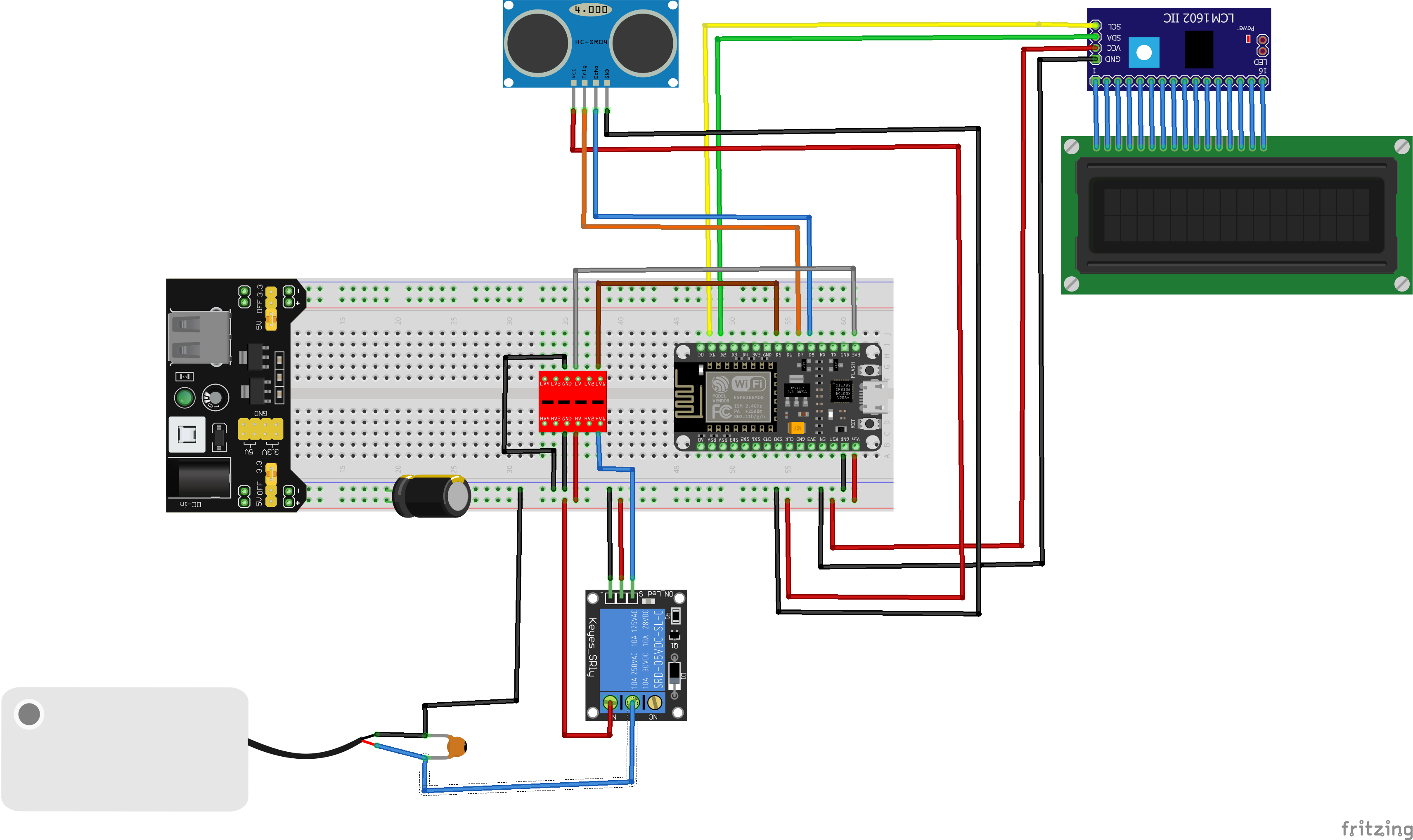

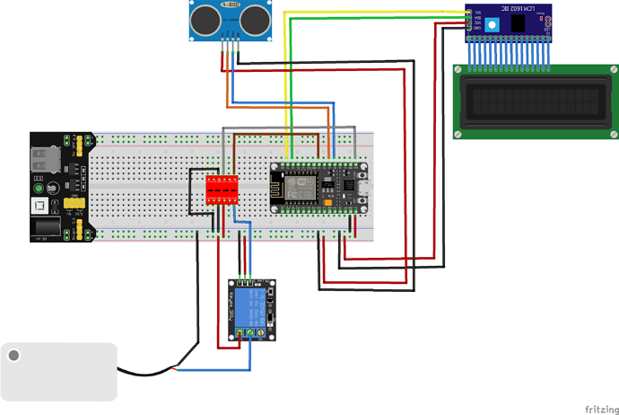

This is a code for my project and I will attach my diagram below. I used my phone charging adapter rated at 9V 2A or 5V 2A to power the project through the MB102 module. I wonder is there any error from all the connection? A logic level converter is used to convert 3.3V to 5v for the relay to work well.
The ESP8266 keep resetting when I connect the pump to the relay but the ESP8266 won't reset when the pump is not connected. The LCD display display weird characters after few resets. I hope my code and diagram are not messy as I am beginner to this. Thanks!
It is a 3-5V and 100-200mA DC micro submersible pump. As what I have seen, the MB102 is able to deliver maximum 700mA. I suspect the MB102 is not able to deliver the power needed?

I think you have misunderstood the purpose of the relay. It is supposed to isolate pump power from Arduino power so that the pump can't trouble the Arduino.
The pump is supposed to have its own power supply switched on and off by the relay, which the Arduino controls but does not power. By connecting pump ground to Arduino ground, the protection the relay offers is lost.
The pump will draw many times it's normal running current at the moment it starts up. This could be too much for your power supply, causing a voltage drop which resets the esp. You could try connecting a large electrolytic cap, e.g. 470uF, as close as you can to the power input to the relay. This will act as a local power reservoir when the pump starts up, and help reduce that voltage drop. Be sure to connect the cap correctly, they can explode if connected in reverse.
I assume the grey rectangle in the bottom left of your diagram is representing the pump? You need a flyback diode there to protect the circuit against a the reverse voltage that will be generated when the pump is switched off. That reverse voltage may already have damaged some of your components, so be sure to test them all again. A suitable flyback diode could be 1N4001. Again, be sure to connect the diode correctly, with its cathode to +V and anode to -V terminals of the motor.
It's also possible the pump is causing electrical noise when running which is affecting the rest of the circuit, such as the strange LCD characters. Attach a 0.1uF ceramic capacitor across the terminals of the pump to suppress any noise. With this type of cap you don't need to worry about which way around to connect it.
You could consider replacing the relay with a MOSFET. These are smaller, make no noise, don't wear out, and don't need a large current to power a coil like a relay does. Choose an N-channel MOSFET with a logic a logic level gate and a low on-resistance, such as stp16nf06l.
Indeed. The MB102 is very nice for powering a sensor or two. But it's not a proper power supply. It's very, very limited and the 700mA you've read about is far too optimistic. With 9V input and 5V output it would dissipate 4*0.7=2.8W, which it will refuse to do; it will overheat and shut down.
A more realistic current supply capability at 9V in and 5V out is something like 100mA absolute maximum. If you feed 12V into the board or jumper it to supply 3.3V it's even less.

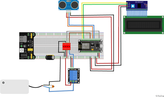

You can connect it to the breadboard, yes, or however you like, but close to the relay. This is so that when the pump starts, the cap is already fully charged, and closer (along the wires) than other parts of the circuit, so it can act as a reservoir.
That diode is for the relay's coil. The new diode is for the pump. Devices like relays, motors and electromagnets all contain coils. When the power to any coil is switched off, a reverse current is created (induced) for a moment which can damage the rest of the circuit. Connecting a diode across the terminals of the coil allows the reverse current to dissipate harmlessly through the diode. Connect it as close to the pump terminals as you can. If you connect the diode the wrong way around, it will short-circuit the pump and the diode may be destroyed.
No, it is connected across the pump's terminals, like the diode.

Hi , as what I have read from your reply , I try to understand it and come out with a schematic diagram. Please correct me if I am wrong. I have put a 47uF polarized capacitor on the breadboard power rails between the positive terminal and negative terminal. Also, a ceramic capacitor 0.1uF is connected across the pump terminal. Is this correct?
