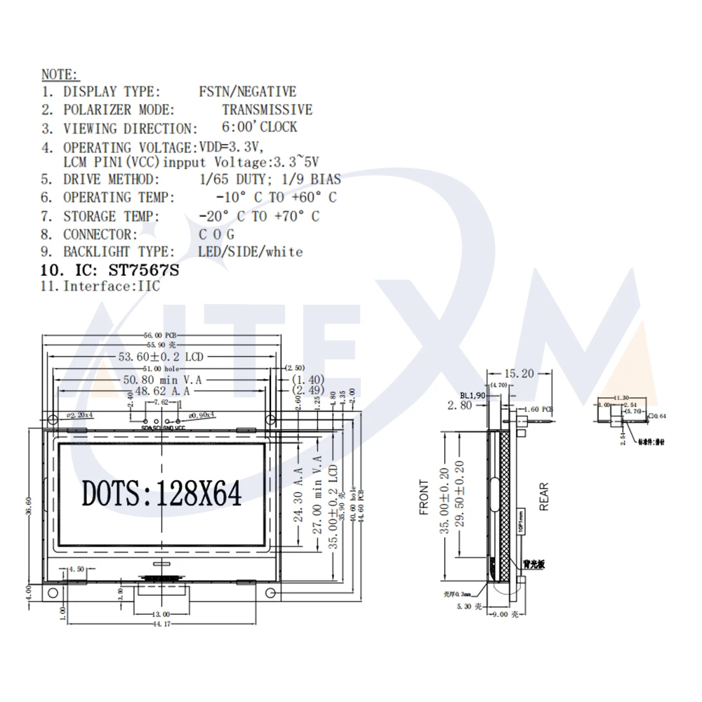

I tried everything, the LCD is on 3V, the LCD scanner returns the address 0x3F or another depending on the LCD I use, the pins are correct.
The latest code I tried still does not work with this display 128x64:

This is the latest diagnostic on a different library with the 128x64 display:
⸮dOI⸮⸮,MH⸮0⸮⸮l⸮⸮̤h|⸮⸮L⸮B⸮
Serial Initialized
I2CexpDiag - i2c LCD i/o expander backpack diagnostic tool
hd44780 lib version: 1.3.2
Reported Arduino Revision: 1.8.19
Arduino Board: ESP8266_NODEMCU_ESP12E
CPU ARCH: ESP8266 - F_CPU: 80000000
SDA digital pin: 4 (GPIO4)
SCL digital pin: 5 (GPIO5)
Checking for required external I2C pull-up on SDA - YES
Checking for required external I2C pull-up on SCL - YES
Checking for I2C pins shorted together - Not Shorted
Scanning i2c bus for devices..
 i2c device found at address 0x3F
Total I2C devices found: 1
Scanning i2c bus for all lcd displays (4 max)
LCD 0 begin() failed: -3
No working LCD devices

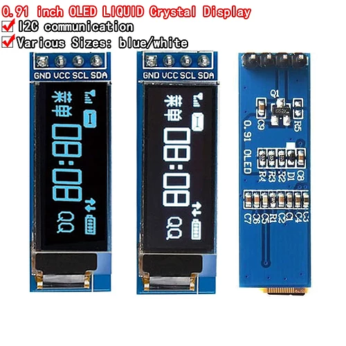

And the last display I have is.
"And the last display I have is."
That requires an/the SSD1306 library.
