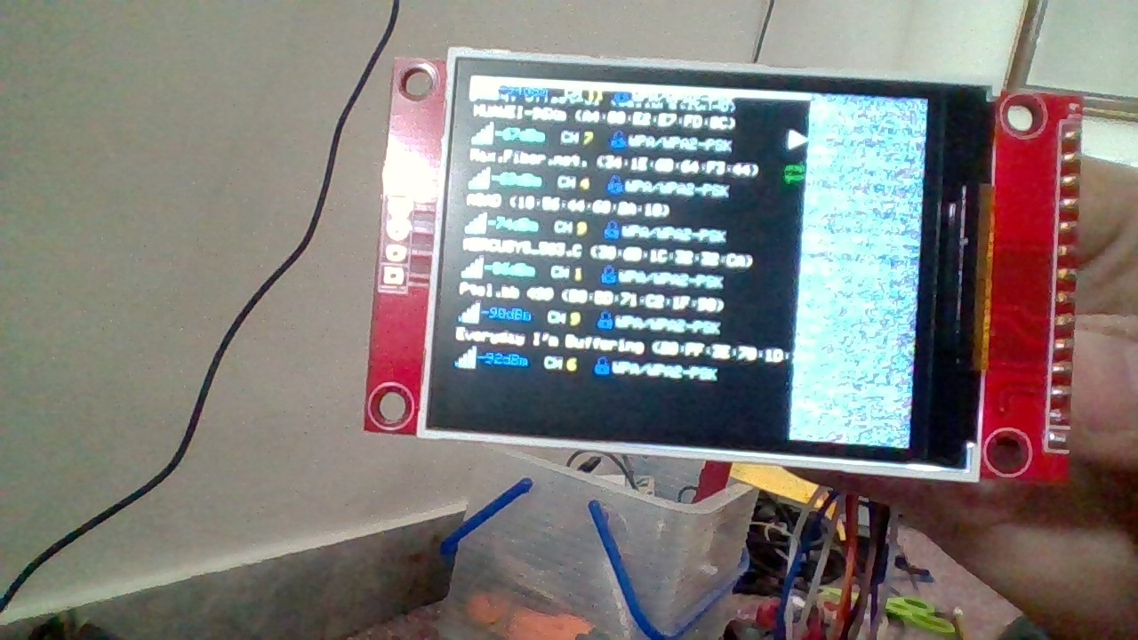

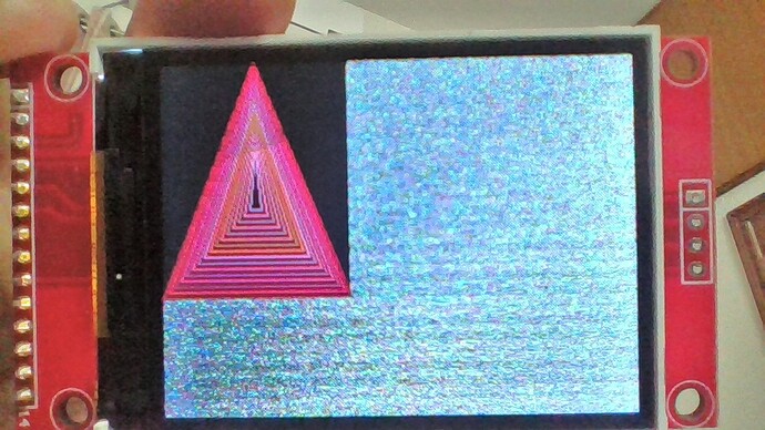

I was making a wifi analyzer using the ST7735 TFT screen and an esp8266. i got a code from one transister website. upon running it, the code was working fine but the problem was that half of the screen was showing static while other was working just fine. i dont have much knowledge about coding so i need help.
here is what im talking about (sorry for bad image quality but you get the idea).
Here is the code:

Hi @flashierbrake9,
seems you have the same problem as here
https://forum.arduino.cc/t/esp32-and-2-4-tft-unable-to-use-the-full-size-of-the-display/1184915/5
Solution pending up to now but it might be worth to follow that thread also ...
There is a hint in post 7 regarding the setViewport function but it was not verified yet.
Good luck!
Hey,
im using a ST7735 screen with no specs from the manufacturer.
and can you suggest me a good driver for it? thanks
I'm not using any ST7735 displays, however you may google using the display size in inch
and "ST7735" as a keyword.
Usually some pages will pop up with datasheets, technical data and hopefully a recommendation for a driver library.
I tried finding some data sheet but i coudnt find any. i even used some of the other libraries. Its the same issue with all of them.
Can give only limited support as I do not have your hardware ...
Did you try the suggestion from the link?

If you measure the unused display width it could be around 25% of the screen width. If it's the case it is quite likely that the driver assumes a 240x240 resolution instead of 240x320.
As mentioned above I don't have access to a similar device therefore can only suggest some trial and Error attempts...

Here's what i got after running the code:

If we go here
TFT_eSPI/examples/320 x 240 at master · Bodmer/TFT_eSPI · GitHub
Herr Bodmer has provided examples using 320x240.
Do any of those "work"?
success!
In the TFT_Rainbow_one_lib.ino example, i Invoked the custom library declaring width and height and uncommented the default declaration.
Line 20:
TFT_eSPI tft = TFT_eSPI(320, 240);       // Could invoke custom library declaring width and height
Nice.
@ec2021, An example, refered to me by @runaway_pancake worked.
any next steps?
