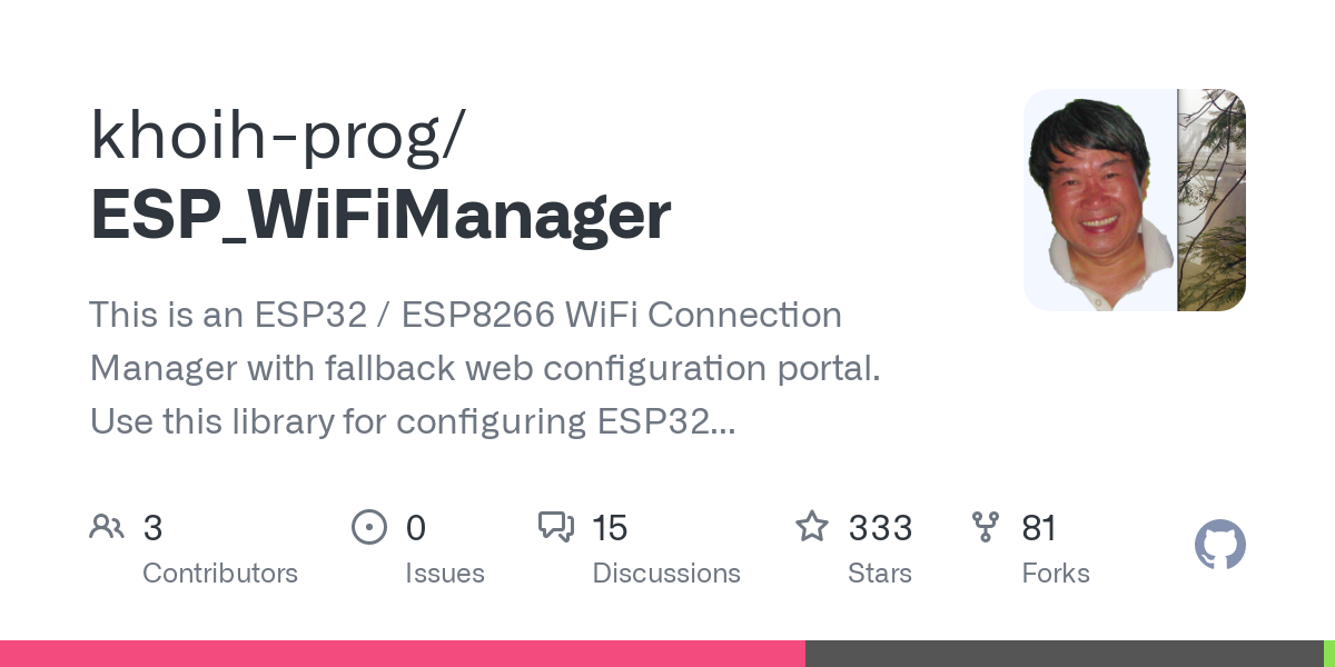

Try this one. I have not tried it but on the Blynk forum it is quite popular

Esp_wifimanager cant do that either.
