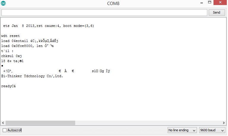

I tried this code from the i got from the internet but this attached photo is the response of the Serial Monitor

I tried this code too and the response of serial monitor is this at the baudrate of 9600 on the attachment I uploaded

As having gone through this rather painful exercise recently with the ESP8266 ESP-01, I highly recommend purchasing a USB-to-serial aka USB-to-TTL converter.
Trying to debug communication to the ESP8266 is a major pain in the butt without one unless you have a Mega 2560 with extra hardware serial ports.

If you have an Arduino Uno with the DIP, then remove it completely. That's what I did.
You have your USB-to-serial converter.
Then use the Serial Monitor to try to communicate with the ESP-01.
115200 baud and CR+LF worked for me.
Do you have a dedicated 3.3V power supply? You need it! The ESP-01 is draws more current than the Arduino 3.3V can provide.

I have regulator circuit for 3.3v to supply the esp01. I'll try to use separate supply to the esp8266 not the supply coming from the arduino uno.
Thanks a lot!
Thanks its working now.
