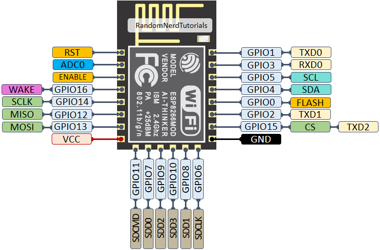

ESP8266 with integrated OLED not working with SDcard
after having successfully realized dataloggers with ESP32 and BME280 with RTCDS3231 and a microSDcard module, I'm trying to use an ESP8266 with integrated 0.96" OLED as a datalogger collecting data from BME280 sensor and timestamp from RTC DS3231.
This type of board uses for OLED screen pin 14 for SDA and pin 12 for SCL.
I was able to display on the screen timestamp from DS3231 and data from BME280, putting the MCU in deepsleep and then awaking it after a fixed interval.
However when I try to save data on a SD card I get different types of error.
In fact, if I use as SPI pins CS 15, SCK 14, MISO 12 and MOSI 13 the upload fails and I get the message
A fatal esptool.py error occurred: Failed to connect to ESP8266: Timed out waiting for packet header
If I use as pins CS 11, SCK 6, MISO 7 and MOSI 8 the upload works but the serial monitor doesn't show anything and, after pressing the reset button, it shows a very long line of strange characters followed by the message "Initializing SD card" (result of a Serial.print command in my code)
since this moment there is a continuous rebooting with the message
ets Jan 8 2013, rst cause: 4, boot mode: (3,7)
wdt reset
load 0x4010f000,len 3424, room 16
tail 0
chksum ox2e
load 0x3ff20b8, len 40, room 8
tail 0
chksum 0x2bb
csum ox2b
v00047c90
-ld.
Since I am a newbie, I tried by googling to understand the meaning of this message and I think to have understood that it's the result of the watchdog timer working and is a "hardware" error ( the number 4 in rst cause ) and should be related to SD card (boot mode: (3,7).
However i have absolutely no idea how to solve this situation and I'm asking for help.
I'm enclosing my code and you will notice that I'm using the library SdFat.h since ,when I try to use - as it was usual for me - SD.h library I get a horrible bunch of errors that I've never seen before and are overwhelming for me ( I searched for an explanatioon and it looks like related to the way in which Arduino chooses which library to use between those installed but I'm not able to solve this problem).

On esp8266, you cannot choose which pins to use for SCK, MISO, MOSI. They are fixed:
Please post a schematic showing how everything was connected when you got this error. Certain pins on esp8266 must be at certain levels to allow the chip to enter program upload mode.
Also please edit your post #1 and put code tags around the error messages you posted.
Hi, thanks for your prompt answer and sorry for my delay contacting you but I spent some time trying to understand the situation and the errors I'm making.
Unfortunately the situation is getting - if possible - more confuse, since, with the same hardware setup and the same code, I get errors different from the previous ones I posted.
To sum up the actual situation
The pins I used for connecting my SD card were derived from examples using NodeMCU as board and I thought (maybe mistakenly) that my board with integrated 0.96" OLED had the same pin arrangement ( the documentation on this board is absolutely scarce)
Here is the nodemcu ESP8266 pinout
and here the connections I used for my board
that allowed code upload but gave me the error
`A fatal esptool.py error occurred: Failed to connect to ESP8266: Timed out waiting for packet header

This long list of errors prompted me to use SdFat library
Thanks in advance for your help
Ok, never mind. Good luck with your project.
Thanks for your encouraging words but I just needed to know which pins I should use for SD card with this ESP8266 board and why even SdFat library gives errors not only with my code but even with "official" examples from Arduino reference.
