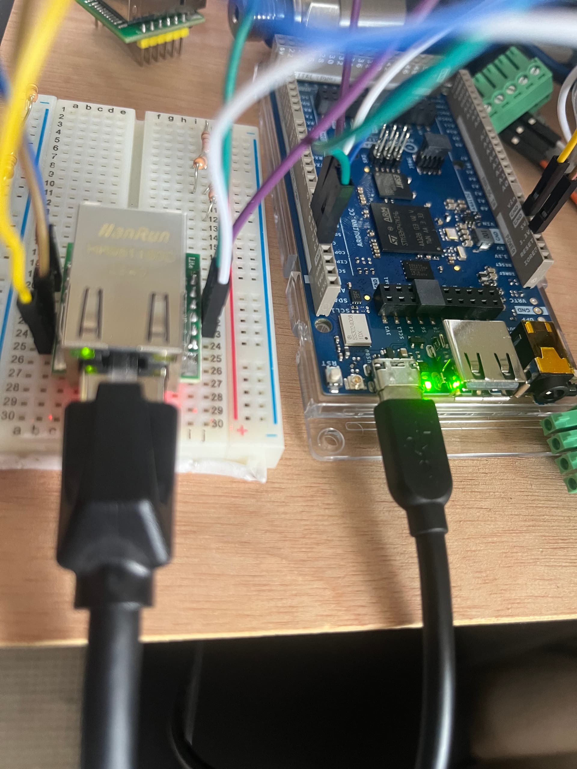

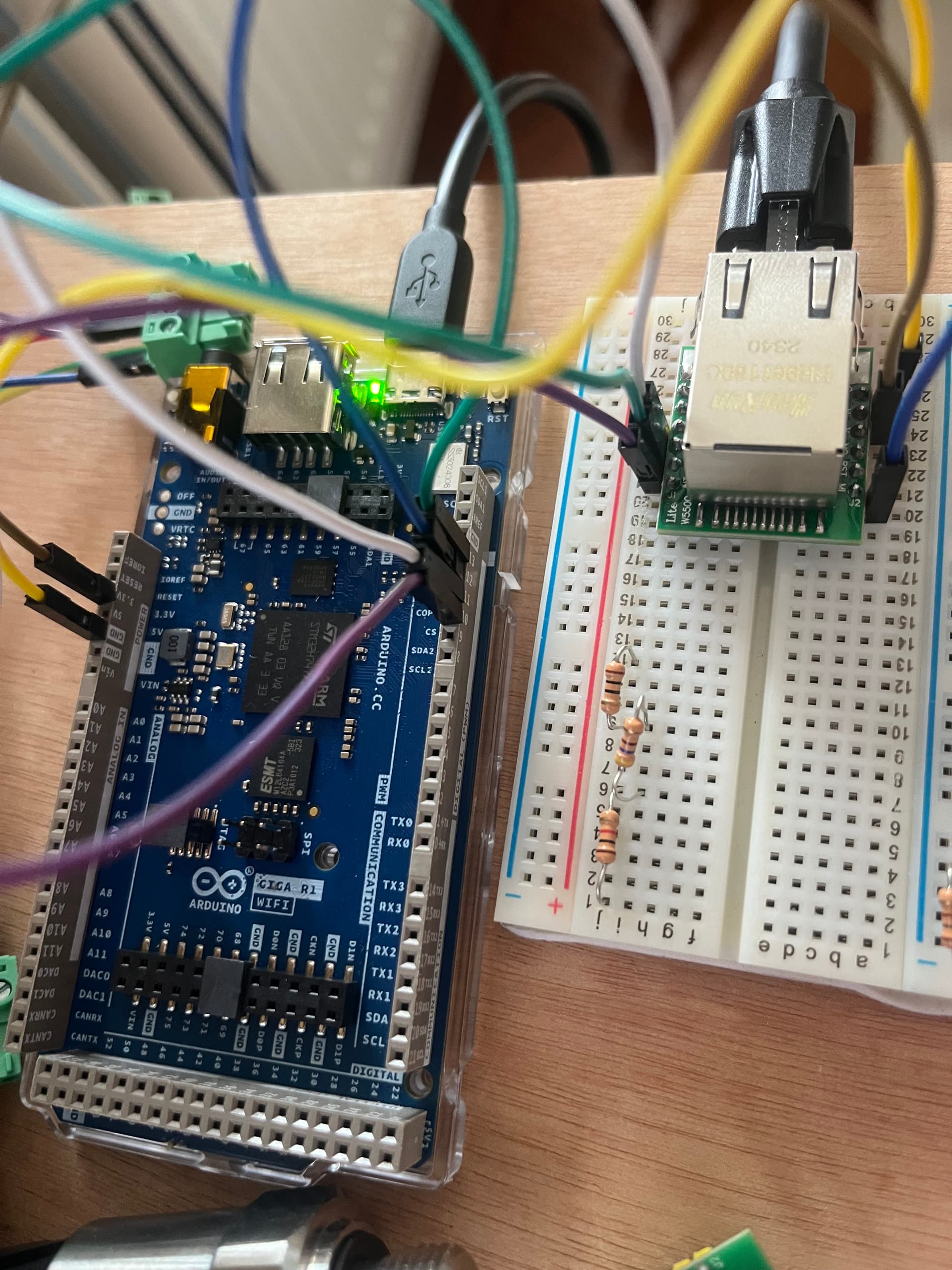

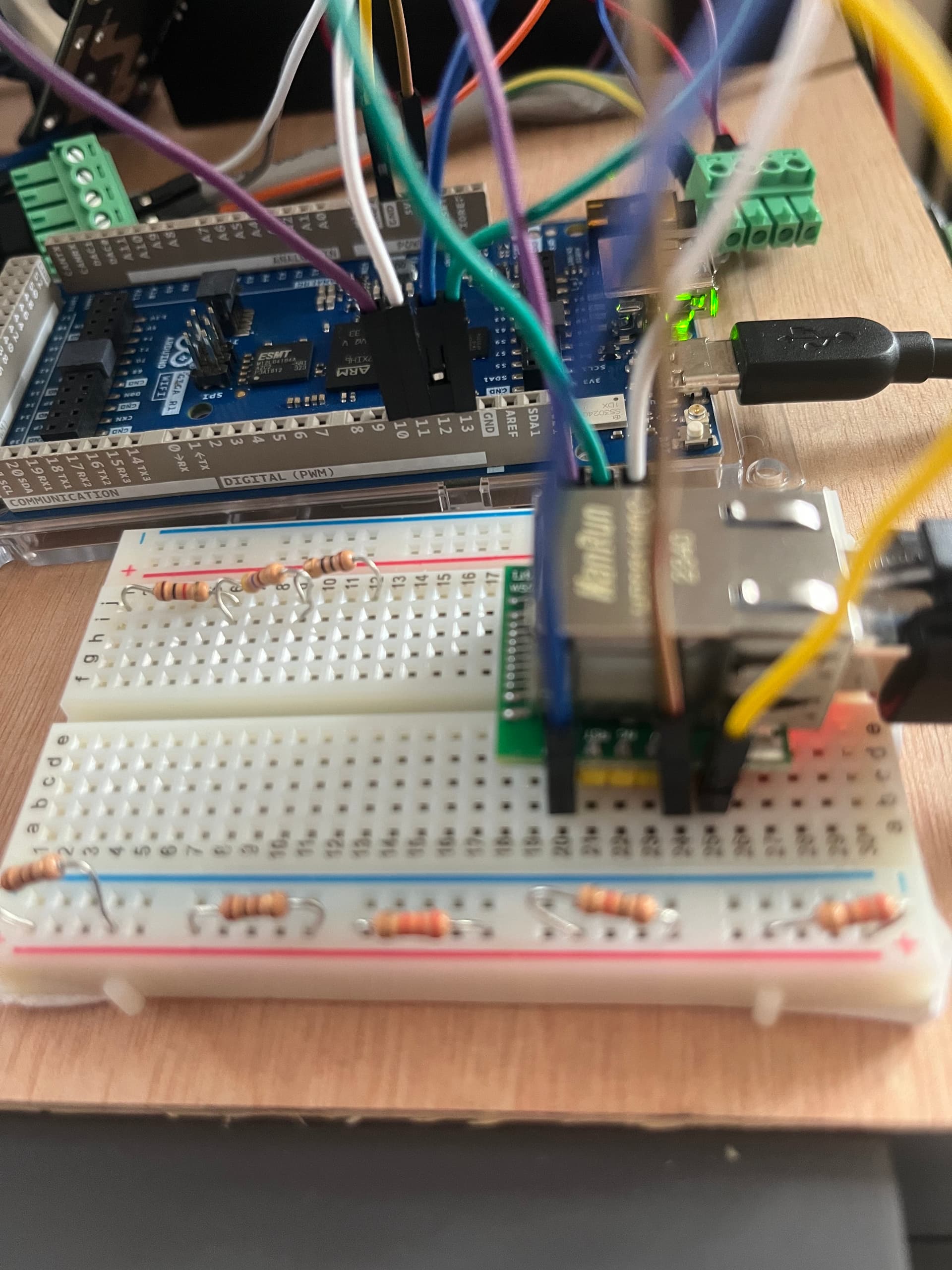

I have it connected to:
D13 on CLK,
D12 on MISO,
D11 on MOSI,
D10 on ss.
But using GitHub - davenardella/Ethernet_SPI2: Arduino GIGA R1 Dual Ethernet project
just to test it with the ethernet.h library i keep getting the response:
Ethernet adapters were not found on both SPI interfaces. Sorry, can't run without hardware.
Would you perhaps know the solution?

The error Ethernet cable is not connected on ETH0. This could be caused by a faulty cable or a mismatch in Ethernet speed between your router and the module (some routers work only with gigabit speeds, while the USR-ES1 may work at 10/100 Mbps).
Yes i understand but initializing the ethernet is not working. So on ethernet.begin() tries to setup the connection but that dhcp and ip are both not working.
why not use SPI0 and the standard Ethernet library or the Mbed Ethernet library with my EMAC-W5500 driver?
Do you have example code? Using spi0?
spi0 is used in every example
I'm pretty new to this so sorry if i don't understand. But you're saying we can use SPI.begin(); with the D13 on CLK,D12 on MISO,D11 on MOSI, D10 on ss pins? i thought i needed SPI1.begin(); for the giga else it selects the wrong header?
don't use SPI.begin. the Ethernet library does it
default SPI is on the SPI header in the middle of the board, not on 11, 12, 13
EDIT: it is labeled as SPI1 in the datasheet, not as SPI0
Okay but i want to use pins 11, 12 and 13 and ss as 10. So that we i'm forced to use spi5 right?
Also i checked your W5500Emac library.
#include <W5500EMAC.h>
#include <PortentaEthernet.h>
Can PortentaEthernet be changed with just Ethernet because i use the giga?
Giga is a disguised Portenta (same MCU). and the PortnetEthernet library doesn't have anything special for that MCU. it is an Arduino wrapper over Mbed Ethernet API.
why do you want to use 11, 12, 13? even the Mega doesn't have SPI there
Because of a pcb i connect that will block the middle pins. So it's possible using the PortnetaEthernet library and SPI5?
I will try later today.
Thanks for the help so far btw
