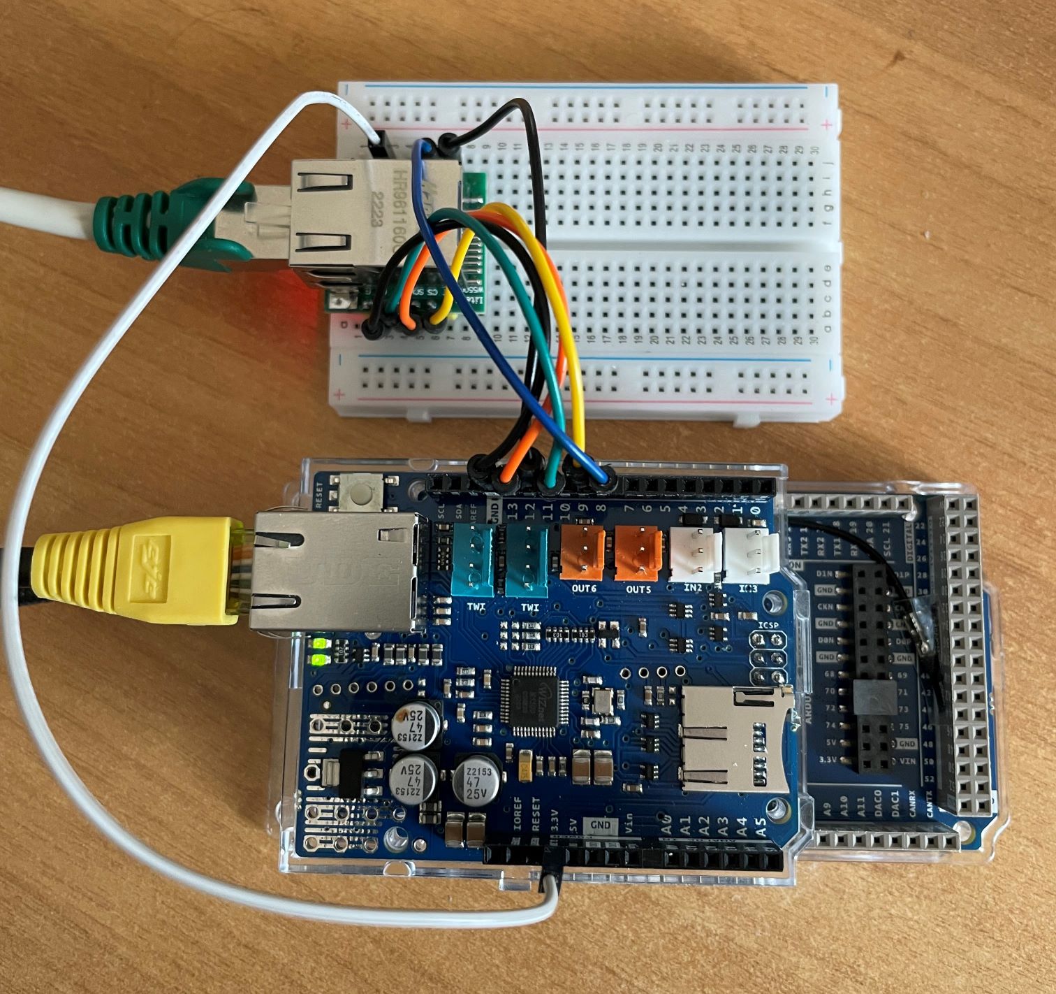

Arduino GIGA R1 - Double Ethernet
Very often, for industrial or very particular applications, it is mandatory to separate the ethernet networks and work with two IP addresses from different groups.
For example, if we need to collect data from a PLC that has a private network and convey them to a server/mes, we need to be able to manage two different IP addresses.
Or, if we want to create a protocol converter between two devices on different networks
To do this we need two Ethernet adapters that can be configured with two different IPs and which, it would be great, could work in parallel.
Unfortunately, the Arduino boards, until now, were equipped with only one SPI interface to which to connect a SPI/Ethernet module (for example Ethernet Shield or similar).
Today with Arduino GIGA R1 WIFI things change: we can use two WIZnet Ethernet adapters on two SPI ports and make them work simultaneously and thread-safely.
Here, you can find detailed schematics and library:
https://github.com/davenardella/Ethernet_SPI2
Enjoy :wink:

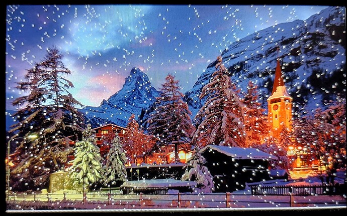

Snowfall effect.
Unzip attached file.
Giga R1 and GigaDisplay.
Zermat-SwissAlps.h in zip file below:
Zermat-SwissAlps.zip (544.6 KB)
Copy code below, paste into a new .ino in Arduino IDE and save it.
Add unzipped Zermat-SwissAlps.h into saved folder.

Hey? I can't find the zermat swissalps library? Can you send it to me on discord my discord is "Fyrekitten", a googe drive link would work also
fyrekittenvt:
Added instructions and Zermat-SwissAlps.h to a zip file in post #10.
ty!!
Hi, it's really nice and interesting. I would like to insert another image, but I can't figure out how to convert it (I have a Mac). I've tried converters, but I don't know the parameters and the image is always distorted. could you give me some help? Thank you
https://lvgl.io/tools/imageconverter

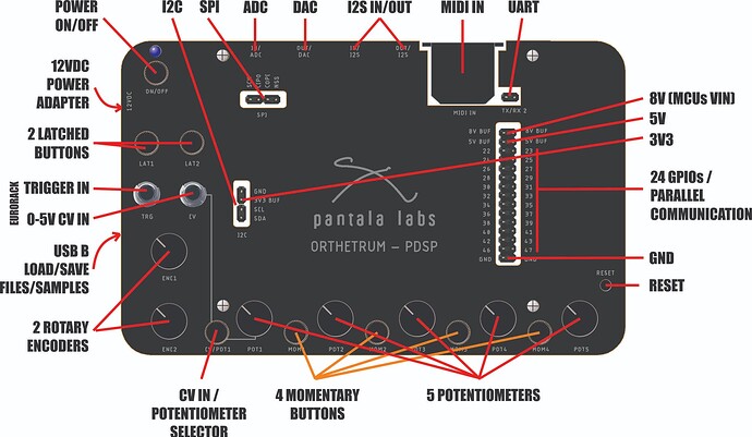

Arduino GIGA - Programmable DSP shield
https://youtube.com/shorts/_vvYhIfnpro?feature=share
