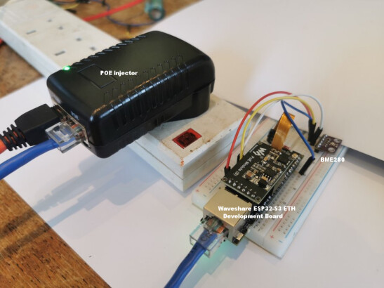

have a look at Waveshare ESP32-S3 ETH Development Board
has ESP32S3 and Ethernet on a single PCB
also supports POE
Does everything you want. All you have to do is pay for it.

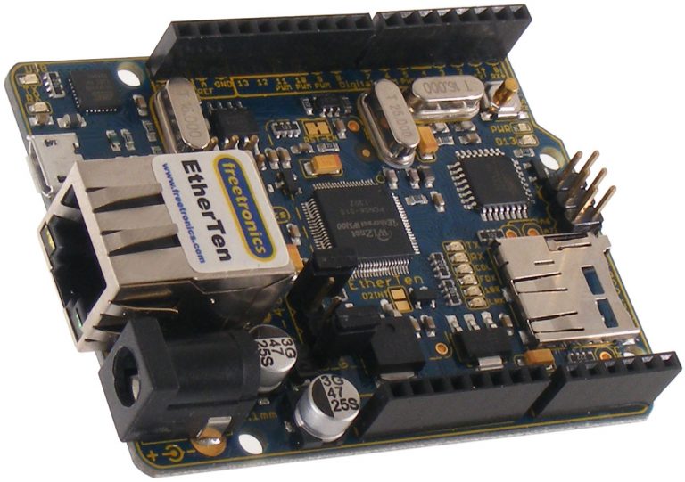

EtherTen and Freetronics have a presence on GitHub.
I didn't realise it was out of stock, and I'm now not even sure Freetronics is still in business. My Etherten is about fifteen years old. There could be several reasons for it being hard to find:
  1. We live in a WiFi world - not cable connect.
  2. I don't regret getting mine, but the Etherten was pretty expensive.
  3. Ethernet on a Uno isn't such a great idea anyway, as its library was a bit of a memory hog and you can run out of memory for other stuff. This does not mean that whatever you have in mind will not work, but you need to bear this in mind.
    And it does not explain the absence of the EtherMega, but points 1 & 2 above might.

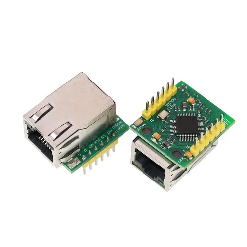

I spotted this compact adapter on eBay. It appears compatible with breadboards, PCBs or stripboard. I've never used one. Don't know about PoE.

photo showing BME280 connected to a Waveshare ESP32-S3 ETH Development Board powered over Ethernet using a POE injector

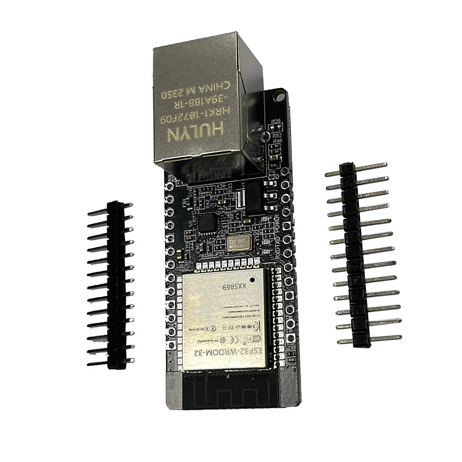

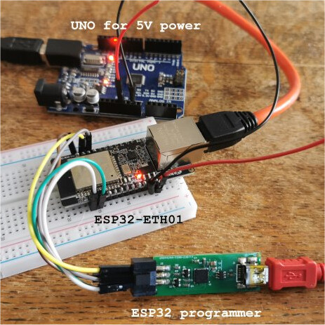

There are many of these Arduino compatible ESP32 boards available on eBay etc.
have a couple of these dev boards
main problems are
  1. requires an external 5V power supply
  2. requires an external programmer
as far as I am aware does not support POE
e.g. photo showing ESP32-ETH01 powered from a UNO with programmer
