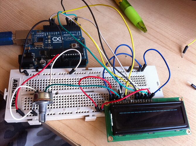

Hi guys!
I have a problem and i hope you can solve it
I would try this example of LCD code and when i connect all parts correctly (and add a 10k pot for the contrast) the lcd screen turns on, the contrast change if I turn the pot... but i can't display any character in the screen... =( =(
This is the code:

You have not yet provided a picture or two to prove you have connected the display correctly. That is the most important thing right now between you getting stuck and getting more help.
liudr:
Ok, i reconect all again and i took a picture:
I use HelloWorld example this time
Thanks for all!

Your code says LiquidCrystal lcd(2, 3, 4, 5, 6, 7); but your photo shows you using what looks to me like pins 12, 11, 5, 4, 3, and 2. I can see that you certainly don't have anything connected to pins 6 and 7.

Looking more closely at the photograph it seems that you may actually have a bad display. You are only getting one row of dots when you should be getting one row of boxes (several rows of dots). What does the display look like when you remove the six wires that connect to the Arduino leaving just the five wires for power, contrast, and backlight?
Don
